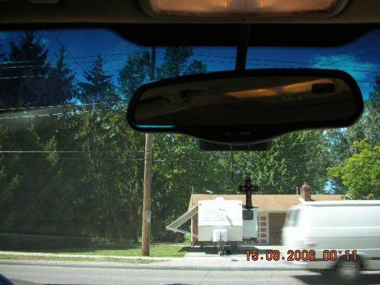

i have done it, but it does not look pretty, the electrochromatic plugs are different, so i had to cut the stock one off and splice it to the 2001, then there is the compass module, it is too big to fit on top of the rain senor. So i tried to take it apart and got the acutal compass little thing out but then i broke a wire off, so the compass doesnt even work for me right now. it did work at first but the big module was hanging and it wasnt accurate. if i could do it over again i would just buy a 2000 mirror. It seems a little bigger tho and maybe ill fix the compass and it will be cool. ill post pictures later if you want

wish i would have known that before, o well my hack job doesnt bother me that much. however like i said, one of the small wires to the compass module came out, explaining why it doesnt work, does anybody know if i can solder that back to get my compass to work? it just seems so small that i cant even see the wire in it.

im pretty sure he means when u buy the actual rear view mirror that it comes with the harness attached just cut off from the car. Mine did thats how i got my electrochromatic to work, i just messed up the compass :confused:
exactly just make sure your comes with the plug (that plugs into the back of the mirror) and some wires attached. That way you you can make sure that the leads are the same style. Then just take them out carefully out of the old and new mirror. Plug them in and that it mount unsnap the compas module off the mirror base and relocate with glue. Mount the mirror. I had a little play in the mirror on mine it was out of a ford taurus. So i put a little piece of steel wire and wedged it in. The wire is covered up by the wire cover that goes to the liner to the mirror to cover the wires. It doesn't vibrate now going down the road. Hasn't come lose in the year of driving niether. Good luck. After I did this install. I did it in my dads 95 Silverado. worked great no play. I am now looking at doing this to my Dodge Avenger. I love having the compass mirror.

I took off the black plastic piece, right now it is just sitting behind the mirror. Does it matter what direction it is facing? Is that where the compass sensor is? Did you glue it to the windsheild or to the plastic on your mirror?

I glued it to the window. The same as if I never removed it from the base of the mirro. I imagine it has to face that way for it to be the most accurate

Following that article for calibration fixed the problem. I programmed it for my TrueNorth zone and then drove in a circle. Works great now. Once I steady it, it will be perfect. The autodim on my old mirror did not work any longer so this will be nice. I got to see that feature work tonight too.
