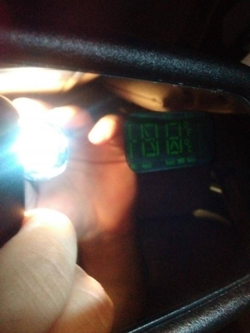

Sorry to revive an old thread guys, but check out what I found when cleaning my rearview in my 06':
You can clearly see in the LCD that the option for temperature is there, but maybe they are just not using this option? Like the part is capable of performing the function, just not being utilized since not connected to the proper input? Can we make it work?
or they just bought the display from the lowest bidder, and that bidder happens to be the lowest because they make it for many other things besides a ford mirror and make enough of them to where they can spit them out for cheap...
more importantly, why would you want it to show temps since the DATC already shows both inside and outside temps?
First, that's not an LCD. It's a vacuum fluorescent display, which is a very different technology. Second, the company that manufactures that mirror actually sells the same mirror (with minor variations) to several different car manufacturers, not just Lincoln. Some of those use it for temperature display. They use the same VFD in all of them because that is way cheaper than designing, building, and stocking separate displays when they are only very slightly different. The LS mirror does not have the wiring connections that would be needed to be able to display temperature.
If you really want that feature, you can buy the aftermarket version of the mirror and install the needed sensor.

Excellent, that's what I figured. Thanks for the info joegr!
