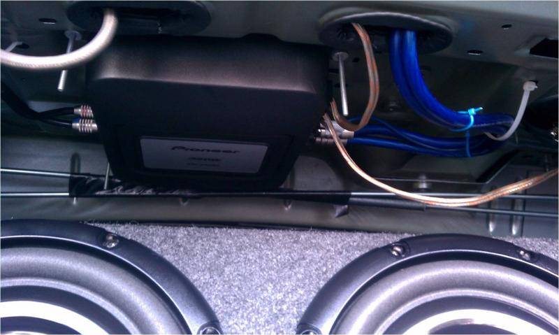

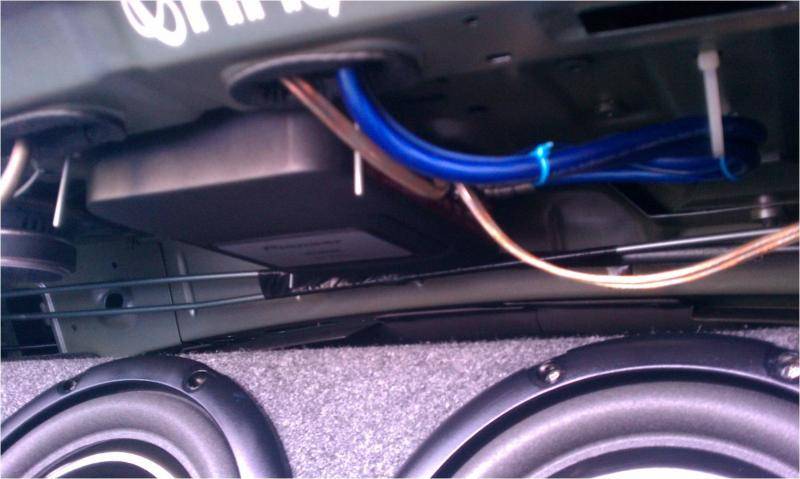

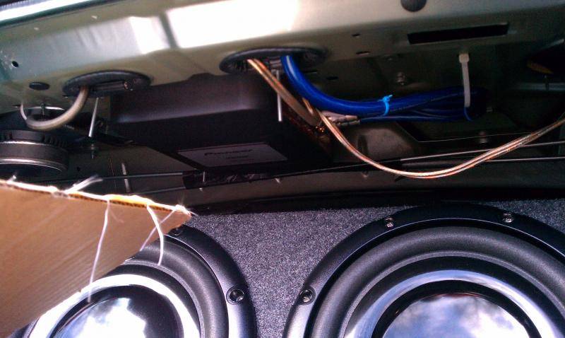

Not a good picture at all - and I can take more if anyone is interested, but I got rid of the old amp and stock subs. I mounted an amp to the back of the rear seat and got a couple cheap 12's. I also marked and drilled four holes in the deck and ran some bolts down in order to mount a new small Pioneer amp "upside down". I put some 6x9 3 way Infinity speakers in the deck and if I remember correctly, I was able to use the stock holes, but did need to add 1/2 inch spacer to get the speakers to "sit" properly. I ran all the wires through a channel that is just naturally there under the rear deck. I was able to put the stock deck carpeting back. It sits a bit higher but is not noticeable at all.
I hated the stock subs and also the placement of the rear door speakers so I figured some "regular" speakers in the deck would help (and they did). The 12" subs I got pretty cheap and aren't great, and the sub box I bought was about the smallest one I could find because I like trunk space and don't need some giant box that weighs 200lbs in my trunk. I am not going to win any competitions, but I saved a lot of space, it was fairly cheap, and they still hit pretty hard.
