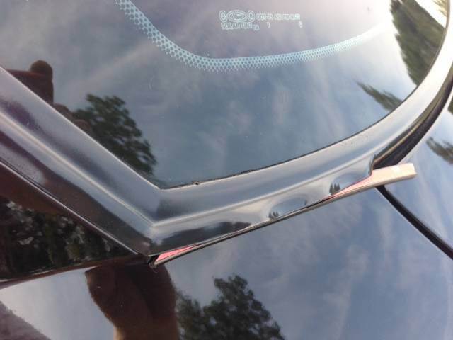

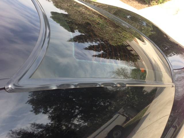

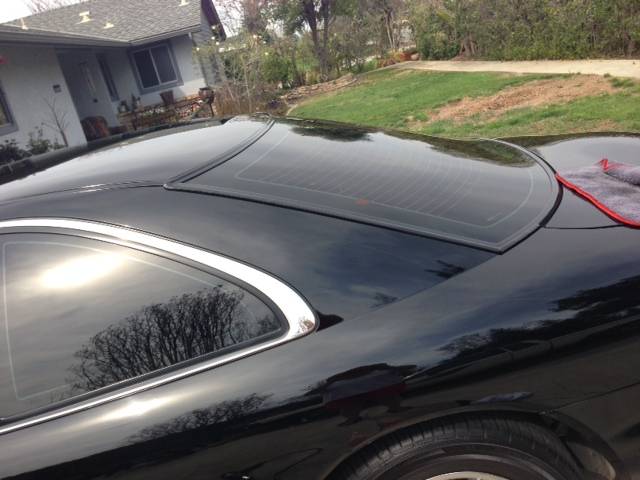

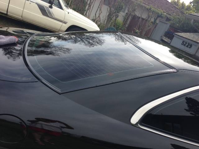

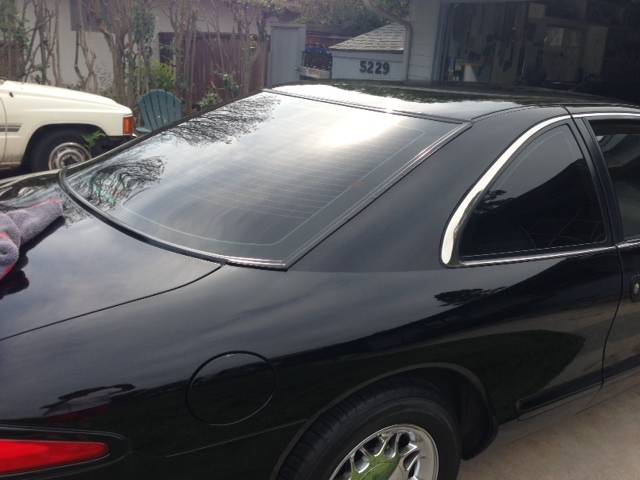

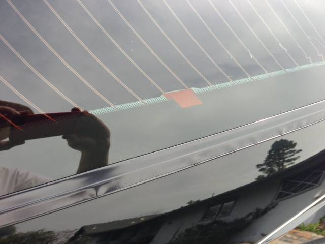

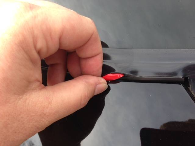

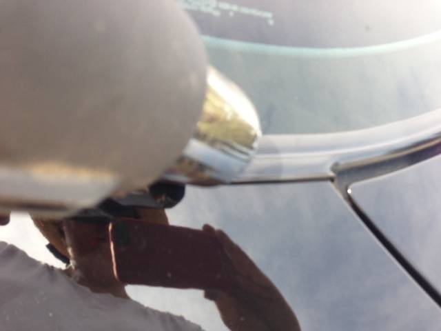

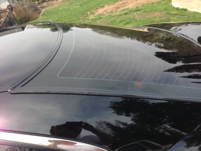

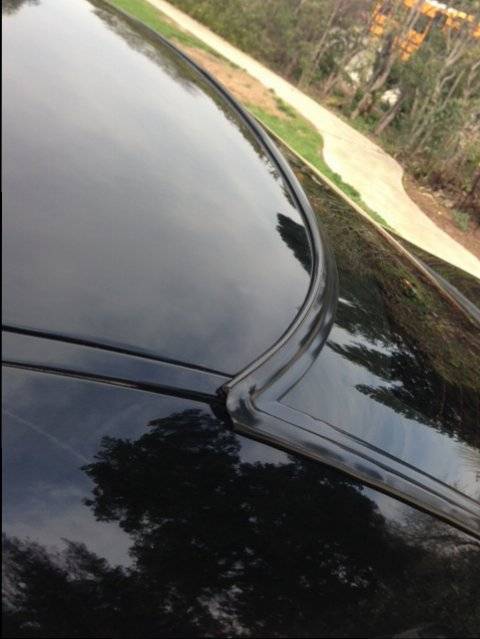

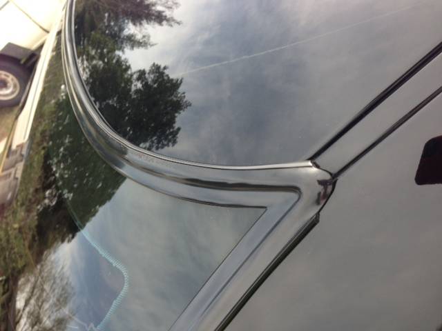

I know everyone has been curious about how the Temple kit works, so here's my two cents. Follow the instructions and clean the underside of the trim thoroughly. It was pretty filthy. I parked the car in the sun for a bit and waited for the trim to soften. I then cut the pieces to size, inserted them adhesive side up towards the trim all the way to the end. I then just left a little out so that I could pull the backing off of the adhesive. Ba da bing, ba da boom. I heated the super lasagne parts with the low setting on my heat gun to get them to really bond to the trim repair. It was definitely easy enough to do. Is it perfect? No, but it is monumentally better than it was. I will report on it after it has had 24 hours to set as well. Would I buy this kit again? Absolutely. It's easy to install and it is worth the money. It was still fairly warm in the pics, so I expect it to settle down upon cooling.

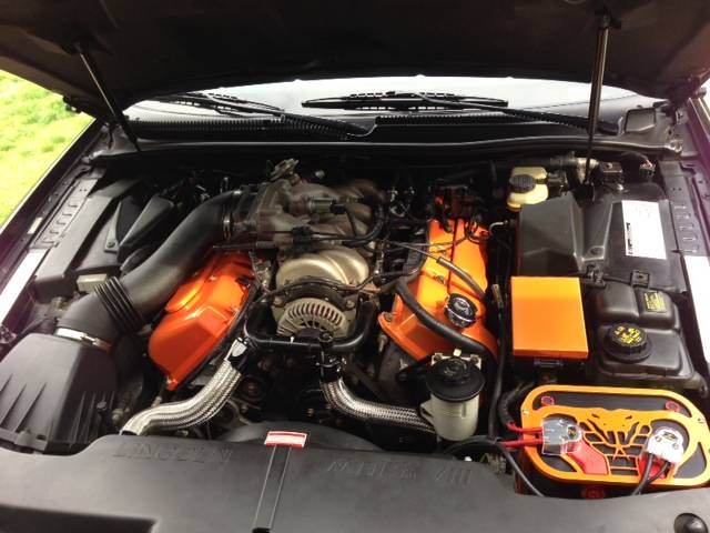

And... I installed the new Optima Battery and powder coated cobra tray, new battery terminals (which are a real bitch with the Optimas) and the fuse box cover. The cover is awaiting a CobraStar that was just won on eBay. Happy dual Mark VIII caretaker and lover!!!!:D :D :D
