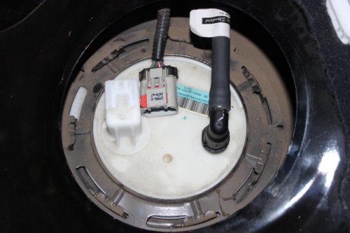

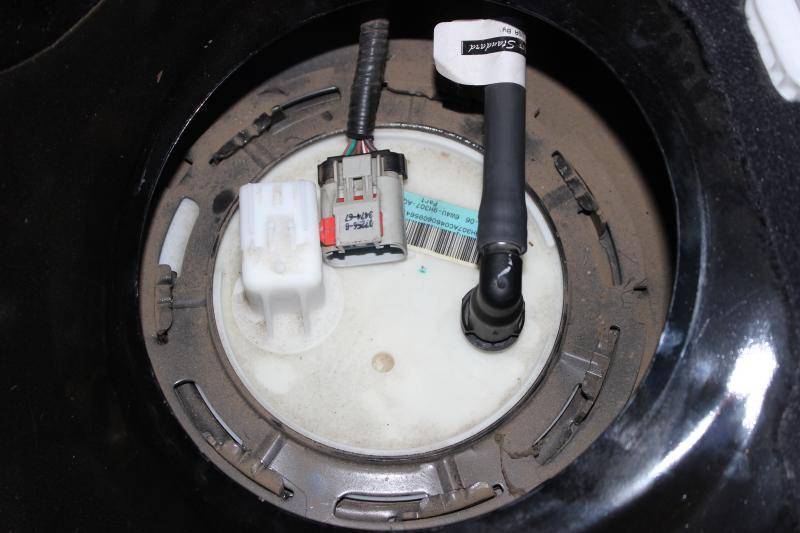

In addition to my car's overheating issue I am trying to fix, it is also exhibiting a symptom where the fuel pump intermittently doesn't complete the priming process. you can "hear" it start, but it doesn't finish. When you try to start the car it just cranks and cranks. You have to let it sit for like 15 minutes and then it will work. It has only done it a few times in the past weeks, but in the past 2 days, it has done it 4 more times... so I need to get this resolved ASAP. I have a replacement pump I was going to put in, but I cant for the life of me get the damn fuel hat off of the tank to get to the pump. I have searched for answers, but everything I see seems to pertain to the 1st gens, as they appear to have a different release mechanism that secures the sender in the tank.

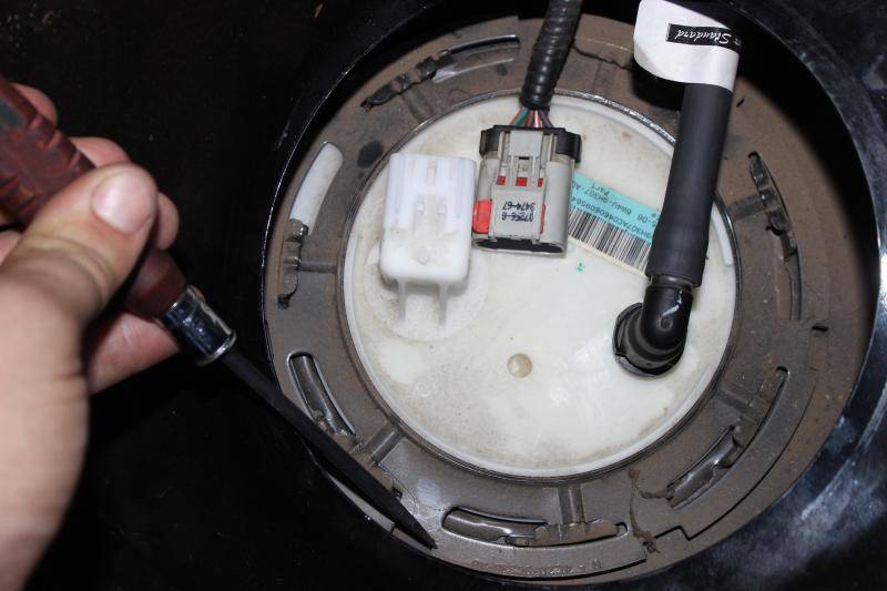

I am trying to use a screwdriver or socket extension with a hammer to slide the outer ring open to release it to get the sender out, but it is NOT budging at all. I have been bashing on it for 30 minutes to no avail. I even tried to pry up on the tabs to try to release some of the downward pressure it is exerting onto the lid, and I have broken 2 flat head screwdrivers in the process.
Am I missing something here? The first gens look to have a white cap that unscrews. My car- not so much.
