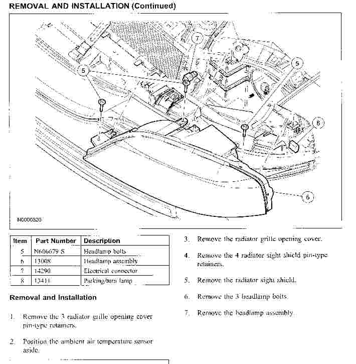

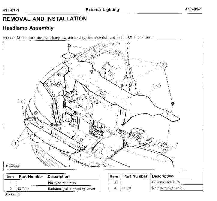

Anybody know how to remove the 03+ HID Head light? which screws are they? the closest ones i see are a 5-star shape (simular to the ones on the MAF), anyone know what size they are?
Hope this helps.
