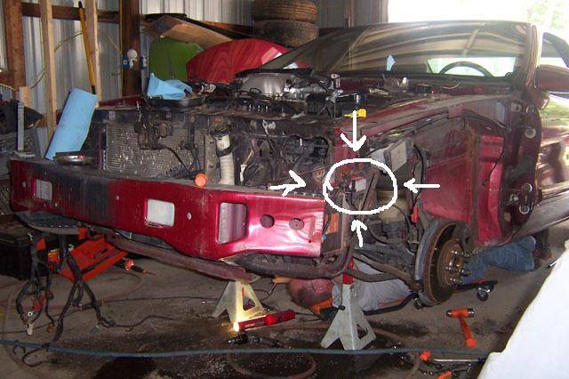

It's not the one for the A/C.....its the relay for the ABS system, it's located in the same place as the suspension one, only on the other side. As noted in the picture.....
Mike
so i can just unplug it from the left side and move it over to the left side and test it out?
