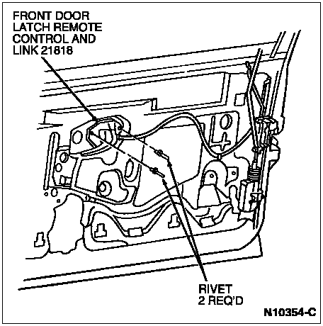

Remote Control Assembly—Inside Handle
Removal and Installation
Remove front door trim panel (23942) and watershield.
Remove rivets retaining front door latch remote control and link (21818) to front door (20124).
Disconnect front door latch remote control and link from front door latch (21812).
To install, reverse Removal procedure.

Is there any way I can use get a bolt size to replace the rivets with? They are the one thing that doesn't seem to have a number associated it with it in your diagram.
I would just get a bolt slightly smaller than the bit you use to drill the rivets out. Just make sure it's not long as hell so it does'nt interfere with other things.
