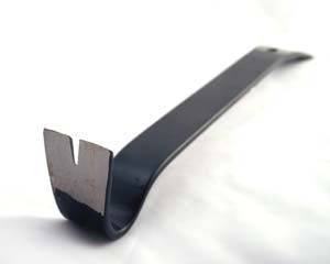

TAKE the LINKS advice and use a plybar (see pic for the style i used) and a LONG bar flathead screwdriver wrapped in duct tape as not to scratch the paint. use the screwdriver to get right down next to the pins and push the door pannel out(this was the safest method i came up with after breaking the first two only using the plybar to peel the door panel away from the door. and get the sockets he recommends aswell and you should be well on ur way, btw the part is about 40$ i wanna say???? wish i remembered the part number....
