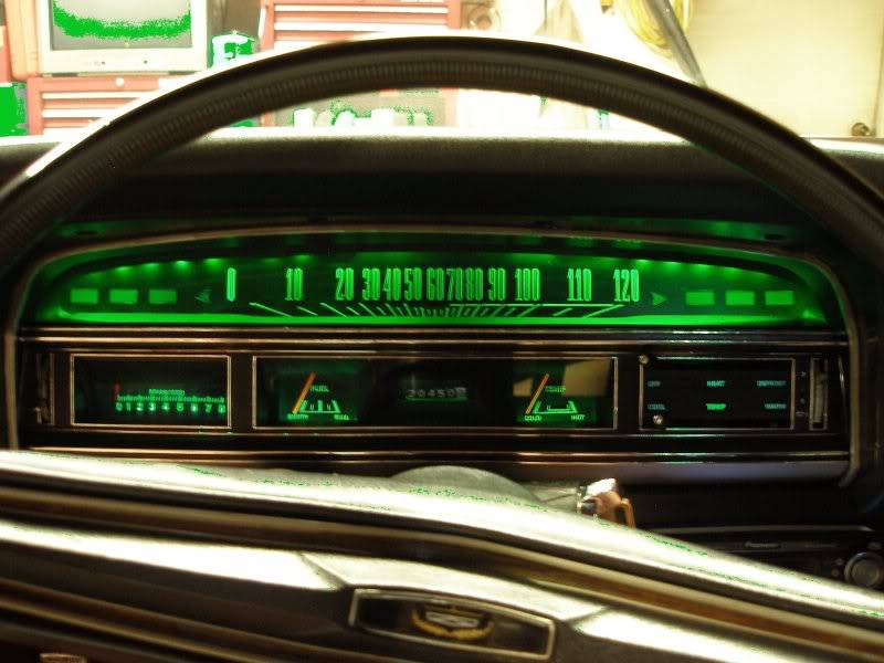

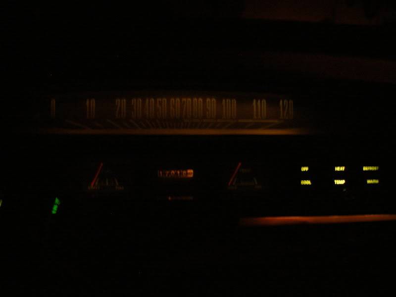

GreenMachine, here are some pics linked from the Torino forums just to give you an idea:
Stock:
Green LED strip:
whats up with the 2nd photo? theres green every where! lol im going to guess that its edited. but i like the idea!
