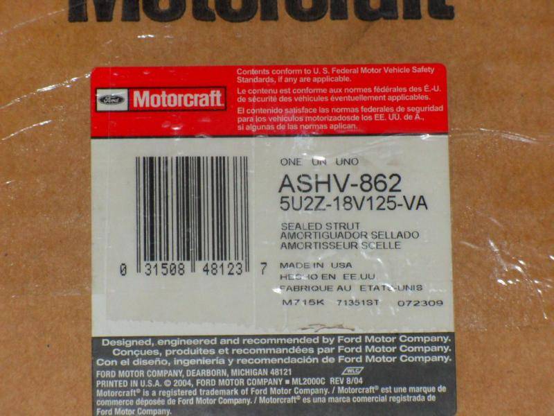

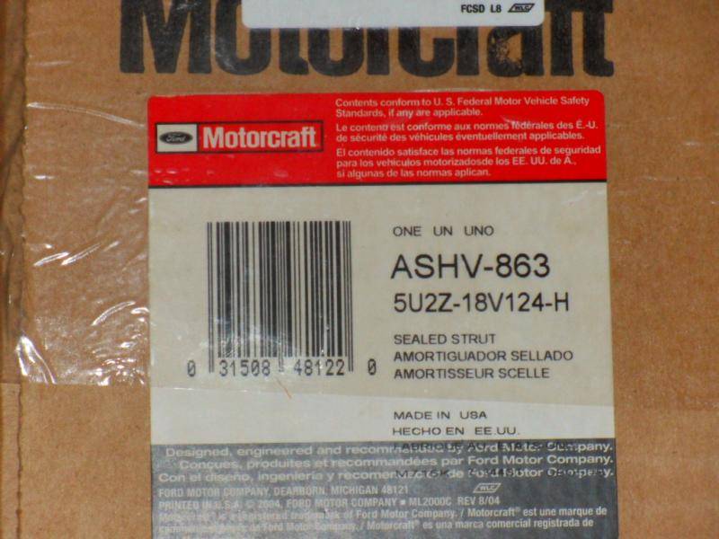

This is what I got for my 01 LS with sport shocks:
According to tascaparts.com part# lookup on the boxes you have pictured:
The ...18v125-va is the rear kit shock w/o standard suspension, performance suspension.
The ...18v124-h is the front kit shock for base, european, standard suspenions.
So that is why I am trying to verify what the correct part# is... as what you have is a Kit... and nothing mentions Sport Shock.

People should reference the ASH# since you have to dig for the cross reference. Keep in mind numbers recently changed from what LDM mentioned above.
The term "Kit" is a joke. I got front sport shocks and they just came with the foam bushing thing on the shaft, no nuts. I then got rear euro shocks, and they came with nuts, but no bushing. Just reuse everything unless you happen to get something new with your shock.

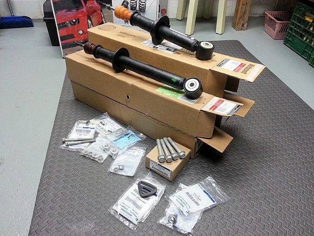

Those colored (orange & purple) rubber dampeners at the top of my springs,
I can't see them on my old set as the boot most likely covers them.
Are these rubber dampeners supposed to stay on as part of the new assembly ?
Only reason I ask is because I noticed ... these new Shocks in a photo provided by LS Sam and
I do not see any of those colored dampeners on them ... just wondering and would like to know before I head
to the local tire & rim shop here in town and end up looking like I don't know what I'm talking about (again!) :confused:
I'm assuming the dampeners stay on as a unit and are then covered by the boot
TIA
^ Thanks, guess I got on the "wondering" side of things when I didn't see them in the pic that LS Sam posted,
but after reading up on it a bit further, it's clearly needed and hidden by the boots. Thanks again!
