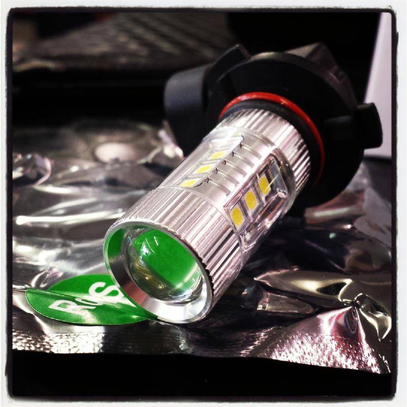

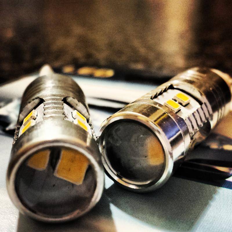

your right false info given by me , here is a pic of what not to buy

ebay works , look for sellers with high ratings and local not China, most will require a resistor , I have Leds in my high beams , reverse , license plate , footwell , puddle , and fogs
for light output, its usually better to have fewer of the large SMDs instead of tons of little SMDs.
and if its one of those bulbs that actually has regular old LEDs, don't bother. it might look cool, but your not gonna see sh!t behind you...
