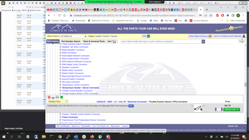

This comes up on rockauto.com but does not look like your photo. Do you have the correct part name that is needing a new connector?
This comes up on rockauto.com but does not look like your photo. Do you have the correct part name that is needing a new connector?...

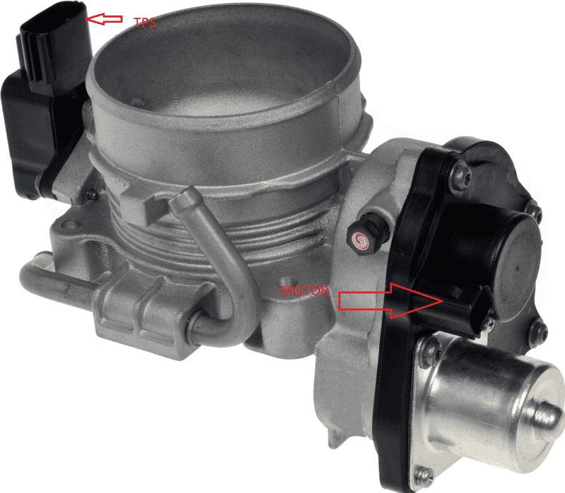

Yes, the picture he shows looks like the two pin connector to the ECT throttle body motor, not the TPS (throttle position sensor). I think that one is three or four pins. They are on opposite sides of the throttle body.
Makes more sense as I don't see a throttle position sensor handling enough current to melt anything.
Yep that's the connector there, the etc motor is the issue. Vehicle runs a bit rough with it unplugged but with it it's stuck in closed loop when I idle and open loop when I accelerate. It's stuck in limited rpm, limited idle, and etc failsafe mode. All the codes rounded back to electrical issues from the 'Throttle Actuator Control Module' and an issue with cylinder 1 circuit that I think I've weeded out to the connector being shorted right at the bend. I'm going to be soldering them both with new connectors within the week so I guess I'll see.
