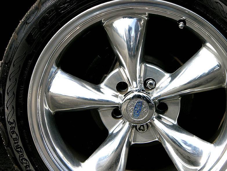

Ok I just ordered a set of new chome 10 spokes and dont want to risk warping them or my set of new rotors. I checked my OEM shop manual it says 85 to 115 foot pounds. Kinda big spread so I call a Lincoln Dealer and they get a mechaninc who says 130-120 ft lbs for alloy and 120-110 for Chrome.
