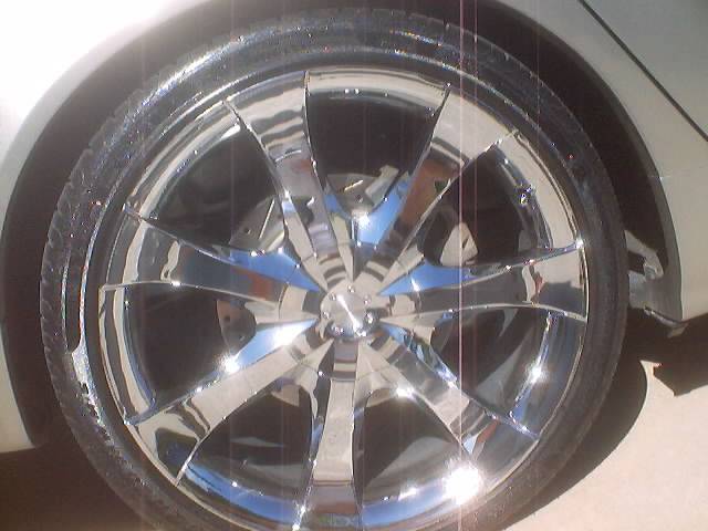

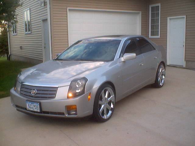

Hi!! I have an 04 CTS with luxury sport package. Ihave 20 inch Giovanna Casino rims with Falken low profile tires. It looks HOT!!!! :wrench
Hey i just bought 20" chrome wheels for my CTS..I love the way it looks. Any tire/wheel place should be able to tell you which wheels will fit your bolt pattern. Good luck! and by the way the performance is still incredible as well as now it looks dang good!

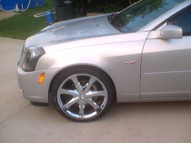

I went with Diablo Fatboys (please don't bite) and the Falken Azenis ST115 20" tires. I originally wanted the TIS 03, but they didn't have them available. I am glad I didn't, because so many 300's have them. Find what you like and try to be original. Good luck :C
