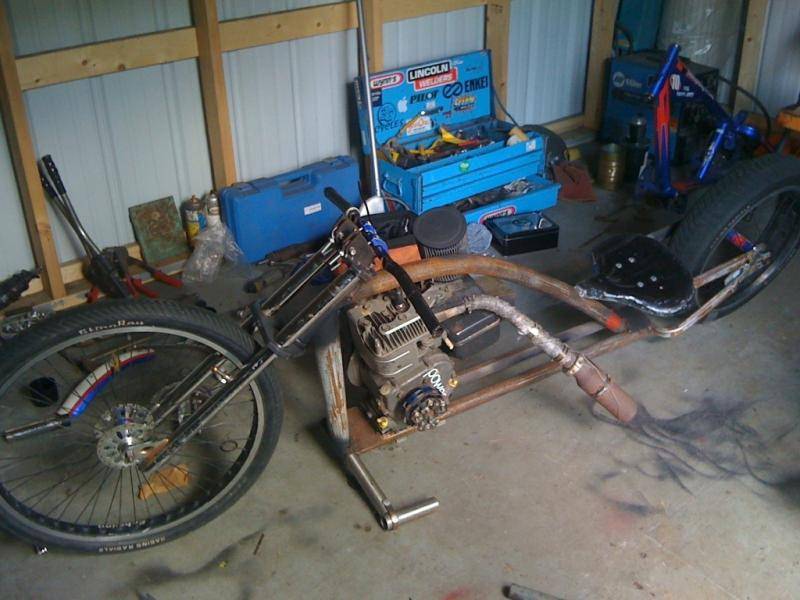

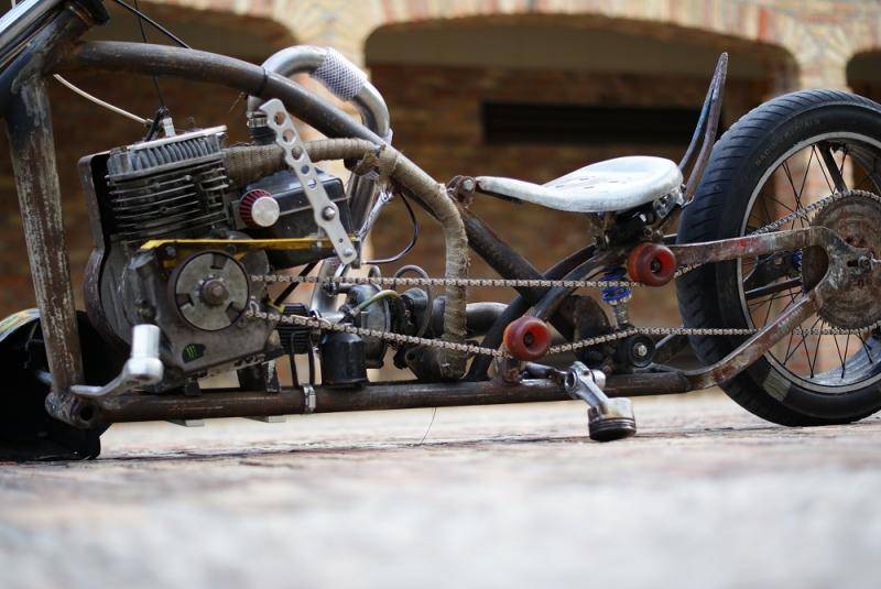

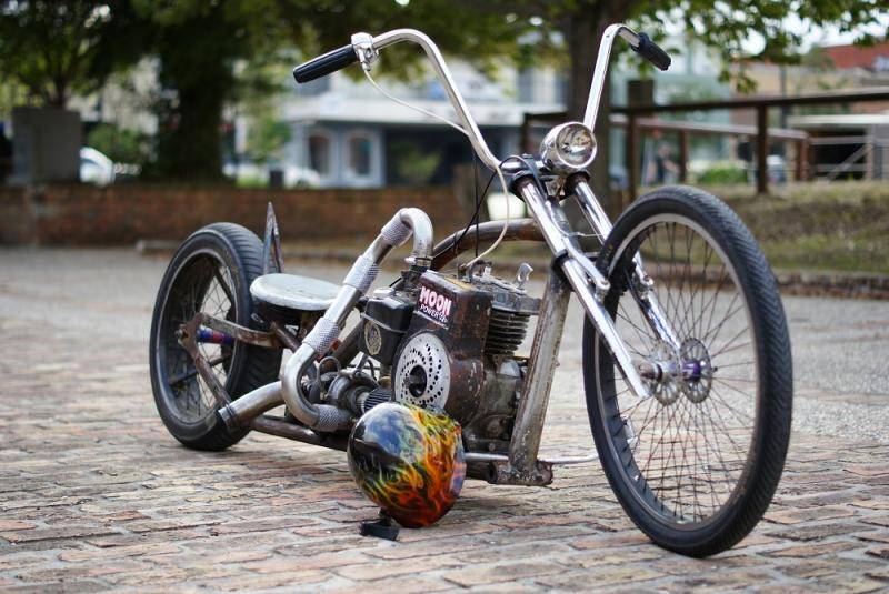

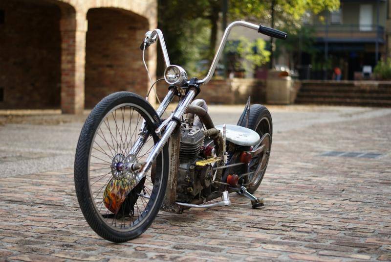

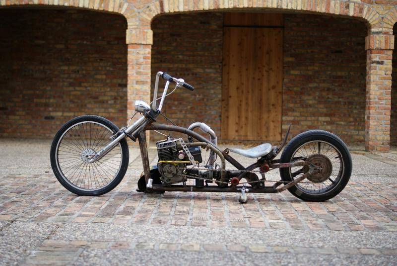

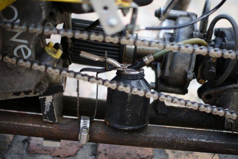

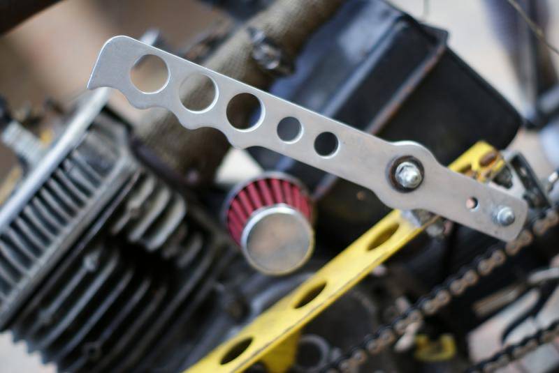

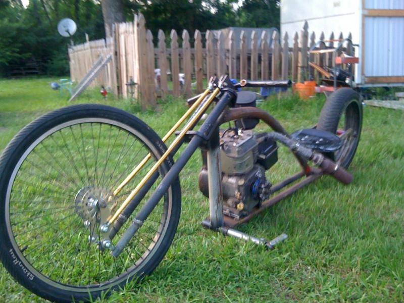

So this is our first motorized bike,pictures have been takin over the years of its build here and there,we built it for my pops with a 'rat style' in mind and he was game for it and was anticipating what we could do with the material and time we had....so here it is. Thought you all might get a grin out of this.

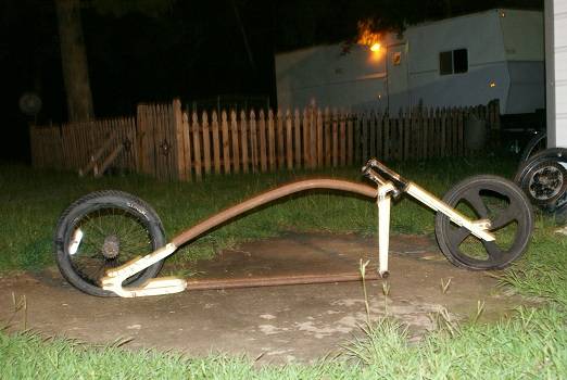

In the beginning. We took a Stingray and 'bobbed' it and rode it for awhile with some spray can paint,then chopped it up.

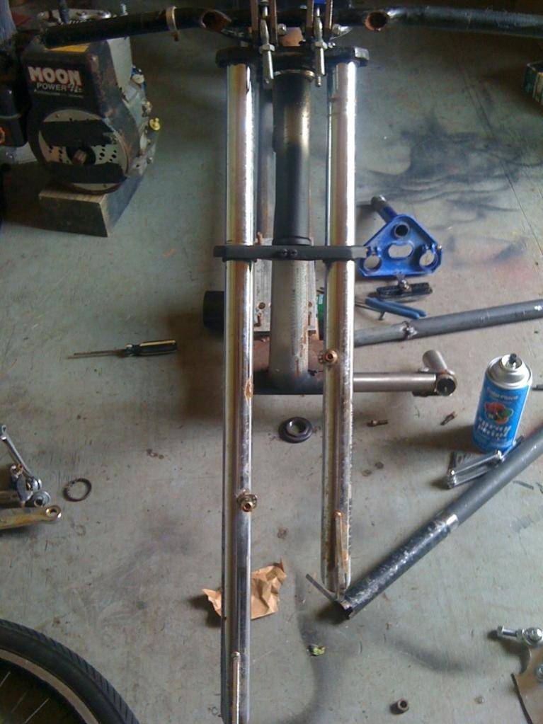

Didnt car too much for the 'adjustable forks' so we wound up cuttin 6 inches out of the stock ones and rewelded the top so they would bolt back on the triple tree.

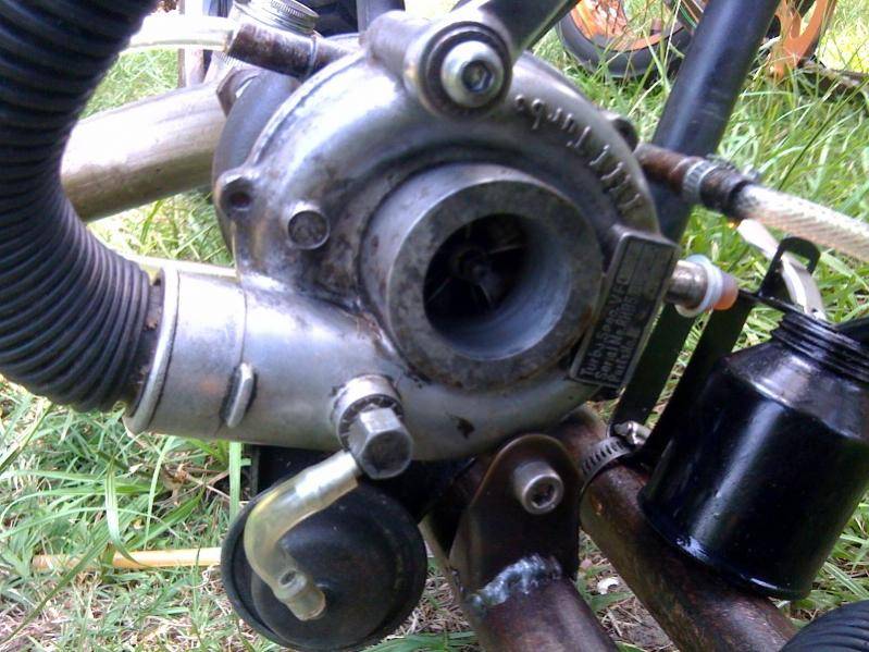

We decided to add a turbo hangin out at the house from a 1983 suburu to our 11.4hp dyno'd methanol briggs.

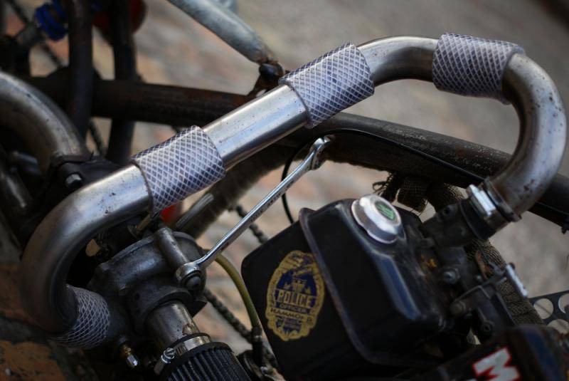

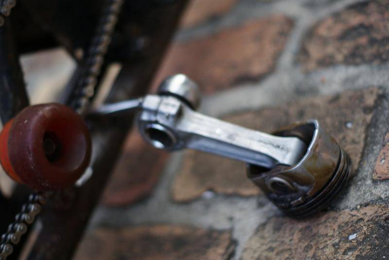

The motor was just wore out,after being raced on the WKA Kart circuit for 3 years and then sittin up for 2,we had it rebuilt. This time is was honed .30 over with titanium valves,billet piston,billet piston rod,a radical cam,the head was shaved then decked and polished,the carburetter was drilled in another spot and an added another pick up hose for the fuel since the turbo spooling up was blowing the fuel BACK down into the tank. Things have been fixed now. The motor alone n/a has 15.5 hp now.
We also have in a few of the pics one blue single disc,multiple weight changing race clutch,it can be adjusted to engange at certain rpm's and there is another rusted looking one,just a regular ol clutch for our ridin around.
