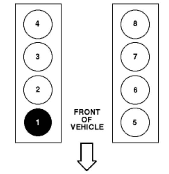

Looks like you got some Hit and Miss going on. I would say Replace All Coils and Plugs. At least change All Plugs, Coil 6, and Coil 8.
