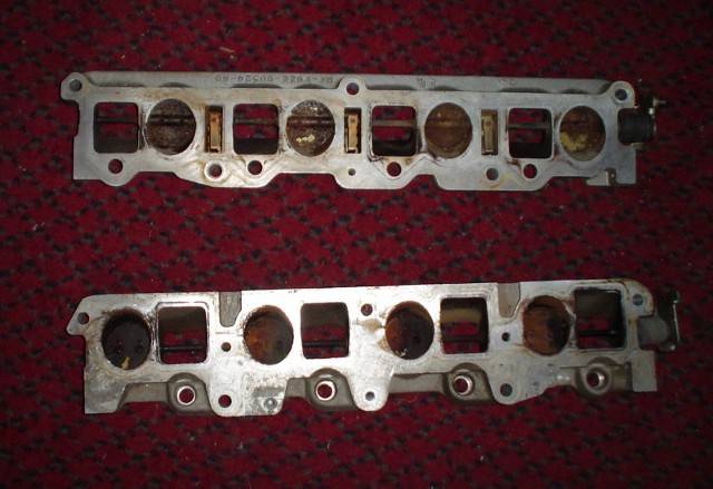

It could be a couple of things. It could be the vacuum leak as described above, but if it was you would have it more at WOT than at idle. It could also be the debris on the mass air, but I am not sure about that. It is possible....stranger things have been known to happen. It could be that you have a sticking IRMC, and to fix that you can use some Sea Foam to clean it up. What happens is that you can get SO much carbon build up that when it opens at WOT it sticks open and you get the stumbling at idle. Cleaning up the carbon will allow them to operate properly in the full range of motion and could fix your problem. It could also be that simply need to change the spark plugs/wires. Mine did the EXACT same thing a while ago. It ran fine at higher RPM's, but at idle it was rough to say the least. I replaced the plugs/wires and it was all good.

Ok, I'm not sure what IRMC stands for, I'm assuming that WOT is (wide open throttle). May sound funny, but I was wondering if there is some kind of glossery for those of us new to this? Maybe a link to common abrebiations that get used in this forum. Sorry, but I'm new...... but anxious to learn.
Intake
Manifold
Runner
Controller
Here's a picture:
