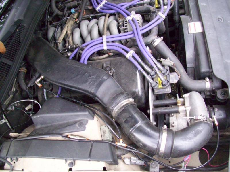

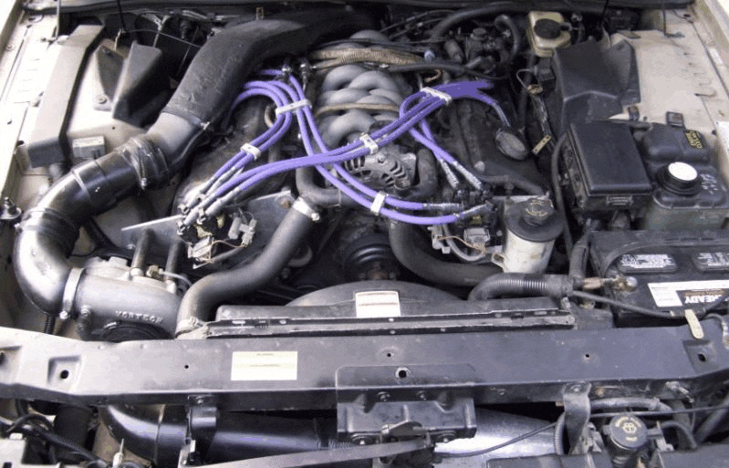

Is there a chance I can get a pic of your setup? I am struggling a bit with this part. I found d some pics but not quite enough detail for a suck through or maf on the inlet side of the SC.
This is the best I could find soon.
I like your mount way better than the Vortech one have. It would have saved me a ton of screwing around in the radiator and fan area. As you already know mine mounts about where your coil pack sits.
