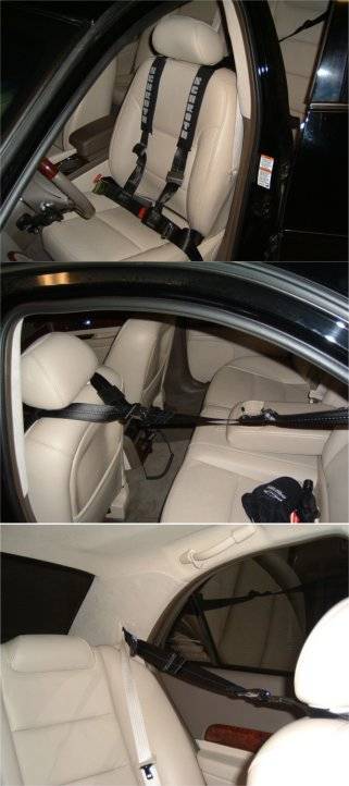

I disable it on race days since I wear my Schroth belts.
I'll I do is click the stock beth together once, and then unclick and leave - it shuts up the 'reminder ding' until I start the car again.
