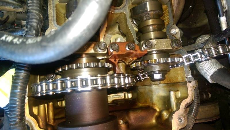

Secondary chain is broke Uh Oh
sevend
Feb 24, 2012
22
Janesville
How can I replace it without tearing the whole thing apart. See Picture
well, assuming you didn't have any valve damage..
i'm trying to remember. it's been a bit since i've had one apart.
replace that tensioner first.
and the other one too. do them both.
rotate the engine to cylinder 1 top dead center.
align the flats on the camshafts.
(pretty sure this is the motor with the flats on the cam.)
the new chain will have a master link unconnected, so you will be able to loop the new chain around the gears.
double check that the cams are in time with the flats, compare to the un-jumped other side if necessary.
set the chain, lock the master link, and then rotate the engine several times to make sure there is no interference of any kind.
then you can try to start it.
but, i highly suspect valve damage. good luck.
The thing with the secondary tensioners and chain is to replaced them well before this happens. You're so much further in now, unfortunately.
Out of time and likelihood of valve damage as already mentioned.
GLWR

that busted tensioner doesn't look all that new to me.

Got it for 4200 included tax and title registration after I took it to my uncle who works at a Lincoln dealer and got a clean bill of health.
only three years on a fixed chain? either wasn't done or wasn't done right (I'm leaning toward not done, if it was done wrong, I'd expect to see a failure much sooner...)
unless that ass hat that did the repair ONLY did the other side!
OP: so did you have any signs or sounds that it was about to fail that were just put off, or was all good until it finally decided to break?
Well Ibdug into the history of dealership repairs and the date the tensioner was fixed was in 01 so the guy I got it from was BS . I noticed it was knocking on my way to work aand drove it there and back was 50 miles to work and back. Got home code tested it dais lean on driver.side did a fuel pressure test and changed the pump and coil packs and plugs. Started it up and knock was still there called the garage down the street he said drive it in and when I started it to leave there was a loud pop and the car killed. After I got it pulled apart I noticed the tensioner metal part was lodged in the chain and when I yanked it out the chain snapped

It's time, deterioration and stress on a weak item. They split in the middle.
If driven while there's already some chain slap, it should be done so lightly and limited.
It's not the best ... as long as the engine is not over torqued.
If the chain slop is already excessive, it should not be driven further, with luck that it didn't already skip timing by jumping on the exhaust cam, or mangled up like posted above.
