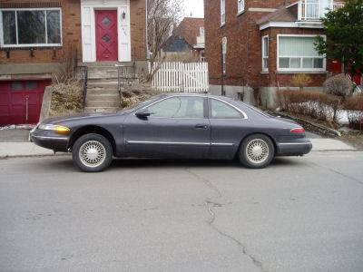

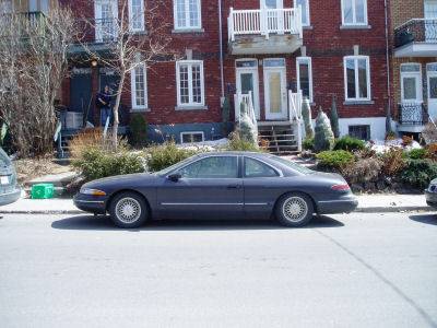

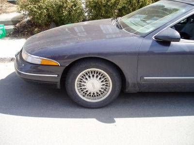

So I lowered the car this weekend. It went ok, but the front is higher than the rear, and I can't get the front to go any lower. So I figured I would just raise the rear a bit.....but today, I turned the car on and the front just started jacking up up up - it turned into a monster truck! I couldn;'t figure it out at first, drove it home like that, then when i got home i noticed that the front left height sensor had fallen out :O So I put it back on, but the car didn't lower!!! what do i do??????? Does it take a long time to lower?
First 2 pics are lowered, last pic is the disaster pic.
