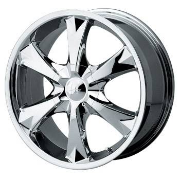

I have 18 inch Helo Chrome rims on my LS that I put on last week. Just found out I'm getting a company car this week, so I'm selling my LS and getting a sports car for my 2nd car. If your interested in these rims, they have 200 miles on them and are absolutely perfect. Chrome 18" with 40 profile tires. Attached is a pic of the rims. Shoot me an email if your interested. bill_lockey@hotmail.com
Looking for $1200 that includes shipping and the tuner lug nuts required. I've got over $1600 in them and I haven't had them on the car for a week, coming off the car tomorrow morning. Anyone interested, shoot me and email and I'll send you a pic of the car with the rims on them. Pic is too big to post on here.

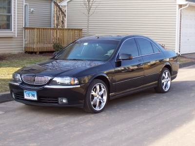

LSinCT said:
Here they are on the car, adjusted file size.
Looks sharp! Hate to hear your getting rid of it but getting a company paid car is nice! I like those wheels!

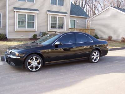

Yeah, they include everything. The tuner lugs are chrome with a special key for all lugs. They are set and ready to go. Tires are Wanli 235/40 ZR 18. They are entry level 18" performance tires. When you get into some name brand tires in 18", your talking $200 per tire. They ride nice though. Here is another pic at a better angle.
