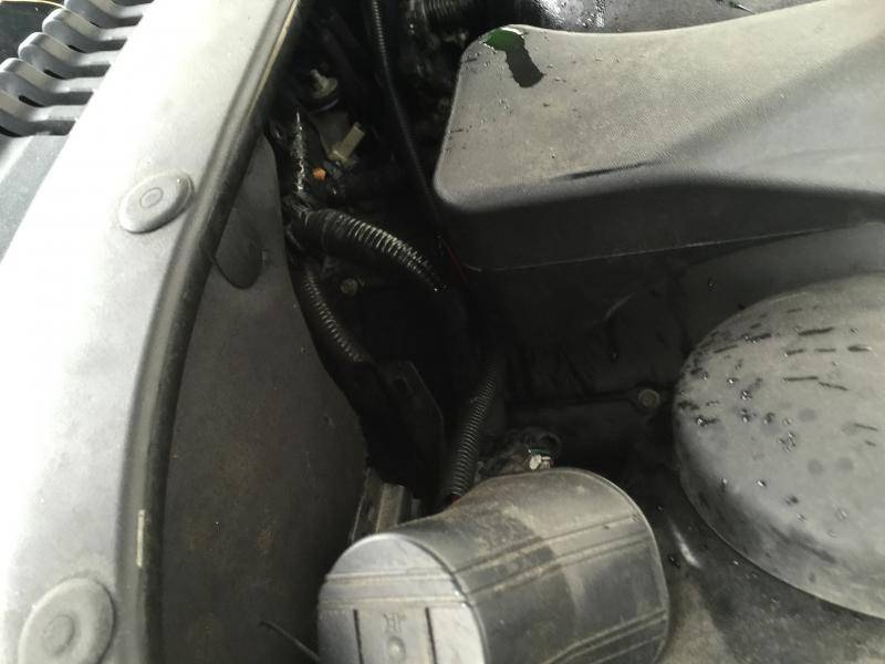

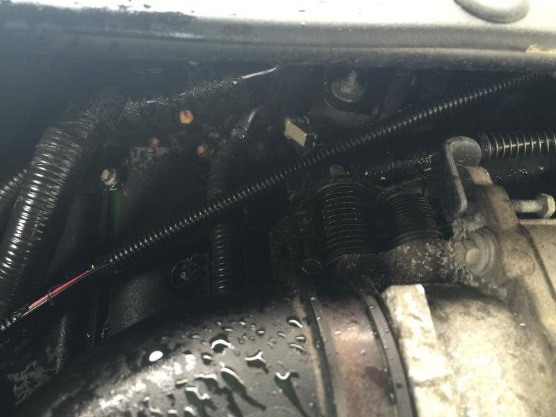

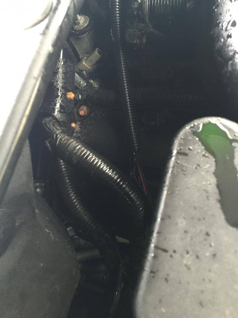

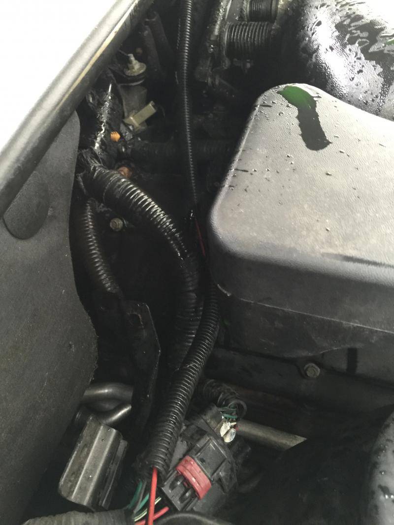

So I was driving and the serpentine belt broke I replaced the belt and now car is overheating and coolant is squirting out, it's pretty hard for me to tell where from, please let me know how I could resolve this situation. Thank You!

Quite interesting because the belt is up front and it looks like the coolant is leaking near the dash, this is very confusing.
I would guess that it is spraying back there from the thermostat housing, but the degas bottle is back there. Anyway, it doesn't matter. Whatever isn't leaking will start leaking after the leaking part(s) is/are replaced. Just go ahead and replace the plastic cooling system parts and be done with it.

In the back, on the driver's side, you will note the degas bottle, a common failure point. And in addition, there are hoses that run across from the degas bottle to the passenger-side and tie into the heater complex. Any of this stuff is a likely source for your leak. Look closely at the various cooling system components and look for moisture. If the first sign of wet is in the back it probably has nothing to do with the belt.
