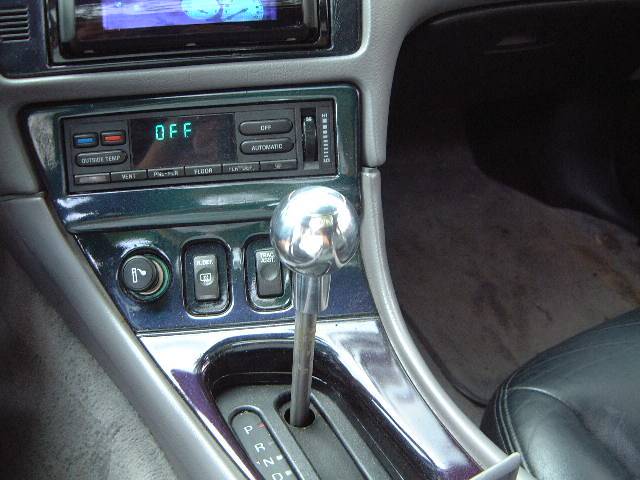

Here is a pic of the shifter knob installed....I like it better than the factory shifter.....
i did the od switch just a little diffrant than ray but i still got it to work , i like the stock shifter i think better, but its your car ray, still looks cool. do any of you know where i can get a shifter boot? prob max.

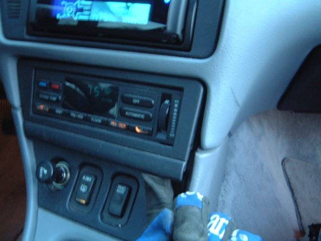

Thats so cool with the TC and OD, I did mine opposite. I have it on the thumb for both. It works like a charm.
If you can BOOT this it would look absolutely SLAMMIN!! Same color as interrior leather.
