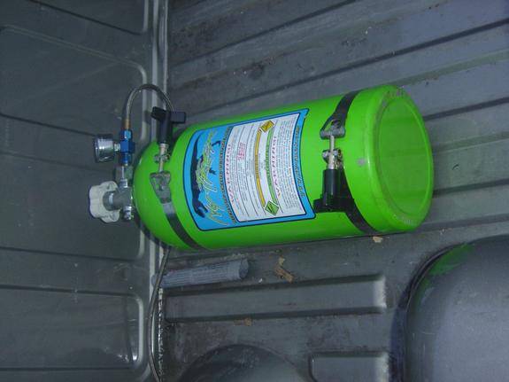

this is my old setup (the trunk ) I have two bottles and they are in silver base now just need to get my lazy busy @$$ back on painting them
