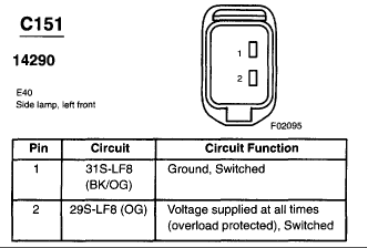

I have a 2002 non-sport. The side marker wire colors are blue with orange (or maybe red ) stripe and a soild orange wire which is positive and which is negative? Please only people who KNOW the answer reply back. Thanks in advance Danny:D

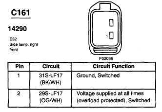

Here's is the connector view for the left side marker from Alldatadiy.com.
