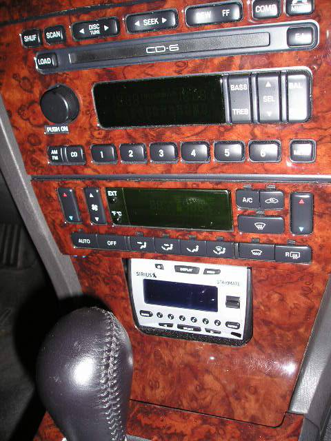

I don't think that one will fit where I did mine, but here is what I did:
Removed the ashtray trim, ashtray and ashtray mounting bracket (IIRC, a 7mm socket.
Test fit the Sirius unit into the ashtray bracket. Then I broke out Mr. Dremel and tore carefully into the bracket, test fitting the Sirius unit regularly. I had to remove quite a bit of material. The unit just pressure fits in the mount.
I used a P.I.E. adapter to integrate the unit into my radio. I hard wired the unit to a 12V source from the radio.
I put a small piece of Velcro on the bottom of the antenna and "mounted" it on the rear deck. I ran the wire behind the back seat trim and under the carpet on the passanger side of the car, up to the back of the dash.

Well, mine isn't perfect but here's an idea.
I purchased the bracket off ebay and did mine
As for the 12v source I but a two way cig lighter and cut it and hard wire it to a 12 source under the dash and pluged in the plug and I ran the wire around the rubber trim on the back window and down in the trunk and thru the backseat down the carpet and up the back of the glove box....You cant see any wires..... The bracket I bough I had to trim alittle off the bottom to get the wires behind it without being able to see it.....The little box under the reciever is for the 6 disc DVD

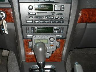

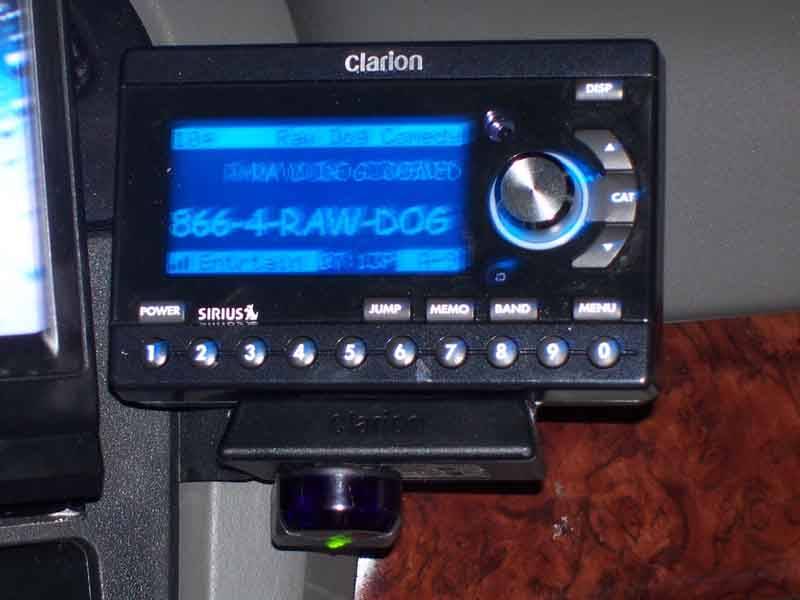

Installed my Sirius Clarion Plug-n-Play and, I have to admit, its pretty convoluted. I pulled out the ashtray and pushed the drawer assembly back in. I then cut a piece of heavy black plastic so that it fit tightly over the entire area and up underneath the bottom lip of the AC controls. I mounted the cradle to the plate with screws provided and slipped the contraption into place. I popped the woodgrain back into place over it and it's totally snug. (It's dead-center, even though in the picture, it doesn't appear that way.) I wired in a dual lighter power unit- used one for the player and allowed the other to peek out from underneath the dash for my cell phone charger. (The antenna is in the center of the rear deck and reception is very good.) My criticisms are that the shifter knob is pretty close to the unit when in park and it slightly obscures the bottom of some of the AC buttons; but I like the center-mount a lot and it can be taken back to "before" in about ten minutes. (Next project: wiring in the audio.) Here are a couple of pictures. (By the way, the antenna is mounted on the rear deck, just behind the brake light- reception is good.)
