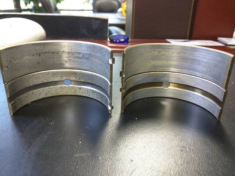

Can't say with complete certainty just yet as I'm comparing used to used, but both the connecting rod bearings and crankshaft main bearings of my 2001 Lincoln LS 3.9L V8 match the dimensions - exactly - of the same parts in a 2000 Jaguar S-Type with the 4.0L V8.
My machinist buddy and I first measured the bearings in all dimensions and then put them in the connecting rods and in the block and torqued them to the Jaguar 4.0 specs which I hope are the same as the 3.9L - can't find the 3.9L specs in any official-looking reference.
Here's my 2001 3.9L crankshaft bearings on the left, the used 2000 4.0L Jaguar S-Type bearings on the right.

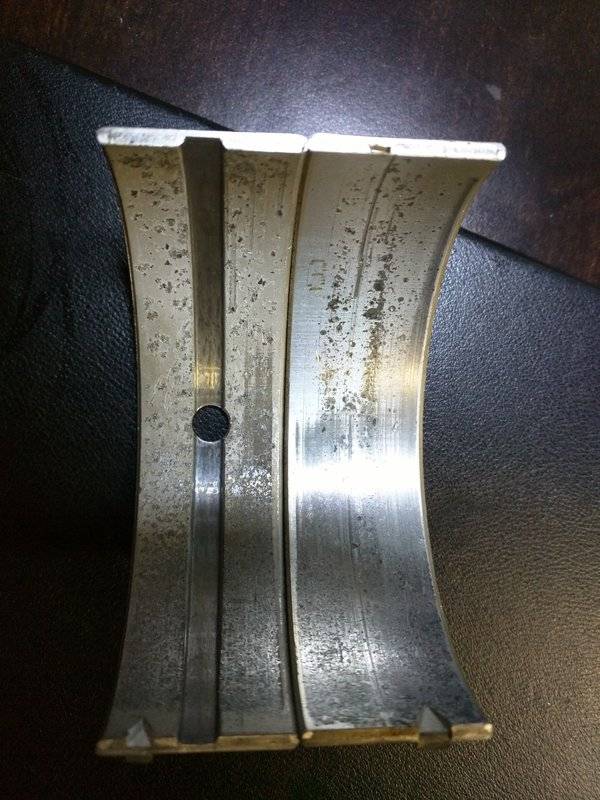

Here's a closer look at my old 3.9L bearings below. The darker grey spots on these bearings are very small shards of what was left of the two connecting rod bearings that spun around the journals and disintegrated in my engine.
So it looks like the coast is clear to order Jaguar S-Type bearings from model years 2000 - 2002 while the 4.0L was the standard engine. If they measure out like these used bearings do, I think my 2001 LS 3.9 bearing problems are in the past.
