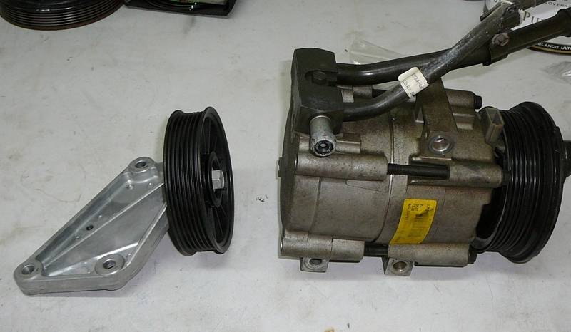

Battery to the trunk, and relocate airr ride compressor to the trunk (if on air still)
Nah. That thing weighs like 5 lbs. I usually add that much weight to the front anyways after I hit the concession stand, and that's even after I have pooped. LOL
The bracket, compressor, and dryer weighs 11 lbs , he asked how to lighten the nose not the driver.
