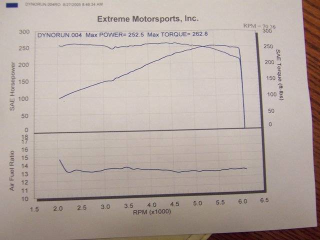

That explains the little squigglies at 3250 on my dynochart!
Here I thought the factory setting was 3000 rpm and there was a delayed reaction going on.
holy bananas,Ford wasnt lying back in 1993 when they said the "new" 4.6 had a "flat" torque curve,i cant believe how that torque is almost linear across the rev range,cool stuff.
what is done to the motor in that dyno run(compared to stock)?
