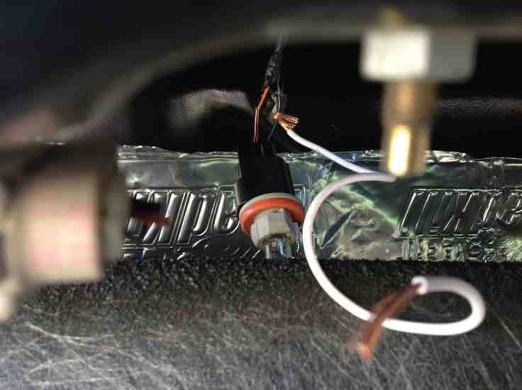

ImageUploadedByTapatalk1374536620.313150.jpgFound the problem!! The neg wire didn't have a good ground or something sorry I was getting frustrated so that's why I asked for help have a good day
Oh I did this just to pass inspection I just have to pop in a bulb and it will always stay on
That "ground" wire is the wire the the REM switches on and off to turn the bulbs on and off. If you ground it, they will be on all the time that the car is awake. (It goes to sleep about a 1/2 hour after the last thing that you do to it.)

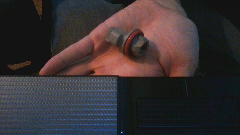

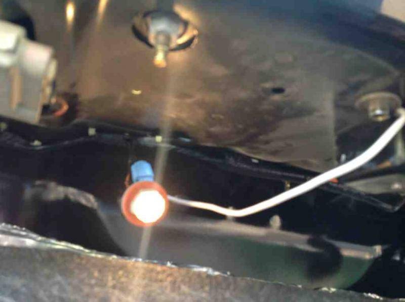

i need to replace the socket that my plate bulb goes into, does anyone know where to get one?WIN_20140617_172457.jpg
This could be it.
13411A Socket Assy **1Z-13411-AA Straight Connector, Rear License Lamp 03/1999 to 04/2006 2 $9.84
http://www.fordpartsgiant.com/partlist/rear-lamps~2006-lincoln-ls-1952284-1953474-1592550.html
Or this may be what you need.
14S411D Wire Assy
Replaced by: **2Z-14S411-BEB **2Z-14S411-BEA 2 CAVITY, Lamp - License, Lamps 03/1999 to 04/2006 -AR- $21.89
http://www.fordpartsgiant.com/partl...~2006-lincoln-ls-1952284-1953476-1592533.html
There are probably lower cost places to get them. Your local dealer may be the best deal by the time you add in shipping costs.
