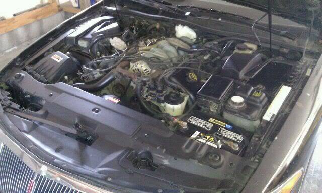

B/Swirl Port: (93-97 Lincoln Mark VIII, pre 99 Lincoln Continental, 96-98 Cobra).
The first and only production Ford head with two (square primary, round secondary) intake ports per cylinder, these swirl port castings arrived first in the ’93 Lincoln Mark VIII. Aptly named, due to the way they promoted the incoming air to swirl into the combustion chambers, much like water running down the drain of a once full sink.
Through the years these heads have proven themselves to be excellent high rpm (8000rpm+) performers—mainly in power adder applications--since their tremendous combined intake port cross sectional area and volume (when combined, a full 55cc more than any other 4.6L head design) provide for exceptional power production in the upper regions of the tach. Ironically, it’s those same big, beautiful, twin ports that also prove to be the B head’s largest inherent design flaw. The extra intake port size has a tendency to kill low/mid rpm intake port velocity and power production—hence the use of Ford’s first IMRC (intake manifold runner control) intake on the 96-98 Cobra. By allowing air to reach only one of a B head’s twin intake valves, velocity, and therefore low/mid range torque production was restored in situations under 3250rpm. Later head designs are clearly superior in this regard, which happens to be the one of the most important considerations for those wanting a stout street motor.
There is also some controversy over the single fuel injector/dual intake port setup. Some claim insufficient air/fuel mixing because of the compromised design, however, others contest that the ability to make 1000+rwhp with only minor porting and some form of power adder is testament to the contrary. Whoever you believe, there is little doubt that even after as little as 8,000 miles, carbon and other deposits tend to form on the secondary ports, causing a major airflow impedance, as there is no fuel present to clean them. B heads feature a somewhat small stock exhaust port that really hinders flow in power adder applications. Major gains from porting come with a quality valve job, some pocket and lots of exhaust work. There really isn’t a lot of material to remove from the intake ports themselves.
The Bottom Line: B heads aren’t the best choice for a naturally aspirated street motor. In order to really shine, they need to be paired with a power adder and a short block that can sustain high horsepower and rpm levels. These, the oldest heads, may still be a great choice for full race applications.
Stock Intake Choices: ‘93-‘97 Lincoln Mark VIII, ‘96-‘98 Cobra.
Aftermarket/Modified Stock Intake Choices: HCI, SSR, PHP.
B head dimensions: Combustion Chamber: 52cc, Intake Port Vol.: 107cc primary (square), 115cc secondary (round). Intake Port Entrance: 1.500x1.300” primary (square), 1.660x1.400” secondary (round), Valves: 37mm Int., 30mm Exh.
