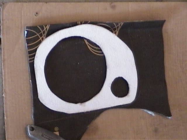

Homedepot & a jigsaw, that's what I did to fit 6.5" where the 6X8's where in my truck. Get the thin pressed wood that looks like cardboard.

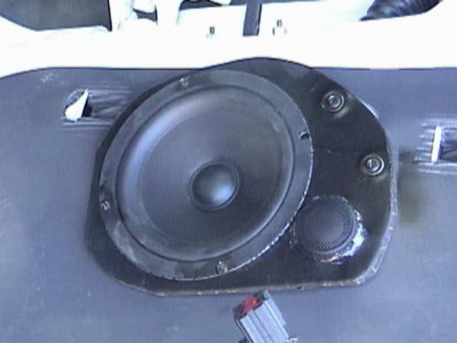

Factory 6X8
Making the plate
Finished install
