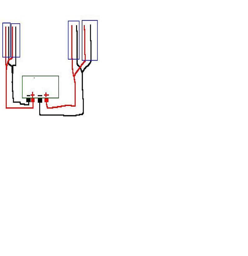

Here is a really simple drawing of what I am talking about, each blue box is a speaker from one of your doors, you wire the two left ones in parallel giving you a 2 ohm load for one channel, then you do the same for the right side and you will have a 2 ohm load for the other channel. There for you will be pushing 300 watts to each side of your car or 150 to each speaker. BTW, if you do this, you had better have some pretty door door speakers to handle that wattage.
Thanks, that helps a lot. That's what I was thinking but was too chicken to try it without asking.

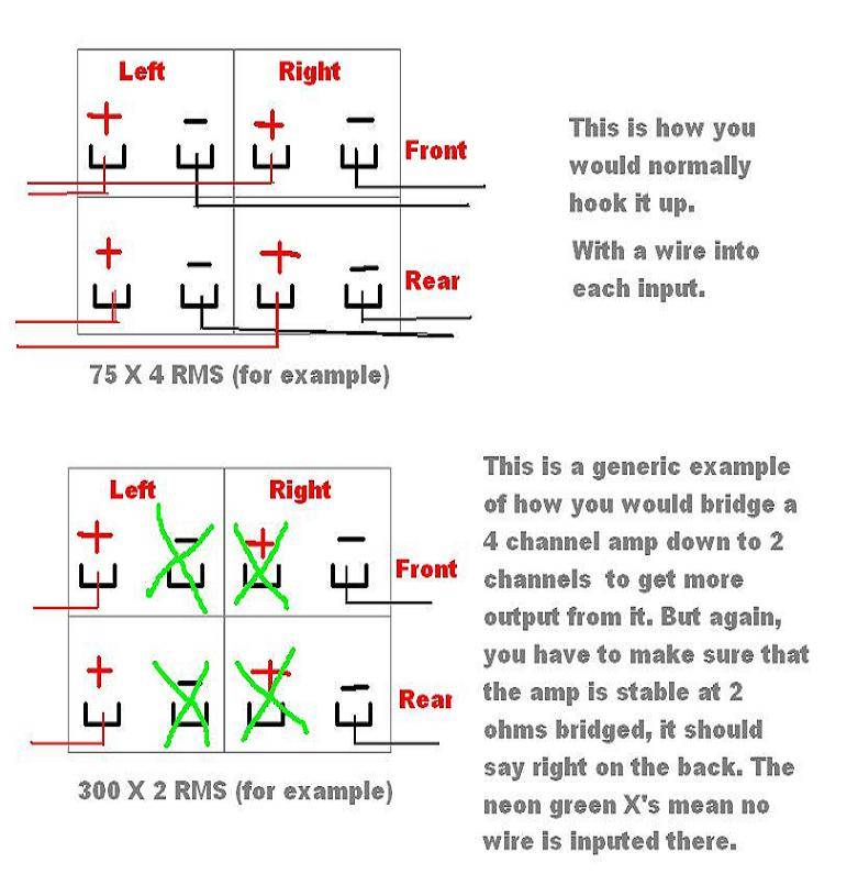

Does this mean the other 2 channels of the 4 channel amp cannot be used once I wire in parallel?
Hmm, okay, im a little confused now, is the amp that you want to run at 2 ohms a 4 channel amp or a 2 channel amp?
4 channel
well, as long as that 4 channel is stable at 2 ohms bridged you should be okay. But you will only be able to use 2 of the 4 channels if you bridge it. On the amp where you connect the speaker wire it should show you how to bridge the amp, i.e. which (+) and which (-) to hook up. Again, this image is a generic basic hook-up how a 4 channel works normally and bridged.
