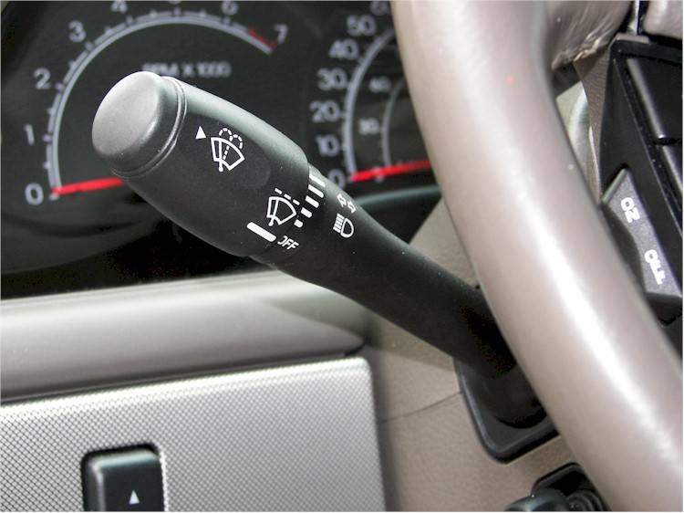

Wellll, let's see if we can drill down a little further and come up with a consensus. I brought along some illustrations...please observe.

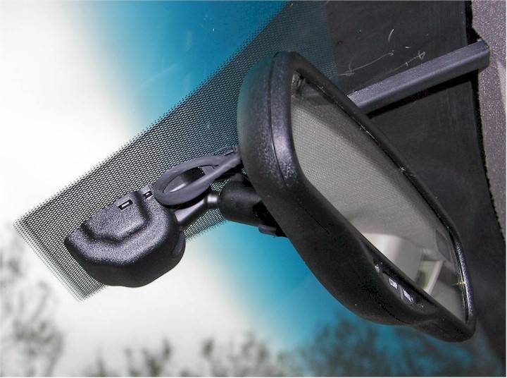

I have what appears to be a sensor module behind the mirror. However, there is nothing on the left (wiper) stalk other than the OFF, Intermittent and Low/High positions. Trust me, the Low/High are there, but don't show in the photo.
Perhaps I have a "stealth" AUTO setting? :D

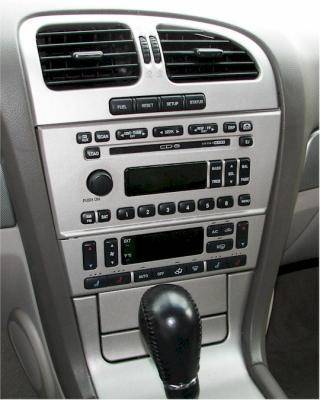

do you have the THX/navi becouse i thought that was the GPS antena on the first pic - i checked on my LS and i do have a 04 ultimate and i have the same - no AUTO setting, i even gave it the benefit of a doubt when i went home it started to rain and i left the wipers on the first setting i accelerated from 30 to 65 and the wipers didnt go any faster or slower.
No, I have the Audiophile/SoundMark 6 CD system.
But now that you mention it, I thought the GPS antennas were mounted on the trunk deck. I don't know that for fact, but have seen photos of GPS equipped LS's with it mounted there. Could be aftermarket (?).
The reason I'm interested is, just this week I tried using my handheld GPS in the LS. I normally keep it in my other vehicle. But it fit nicely in one of the cup holders and I was surprised how well it worked. I didn't need to open the shade for the moon roof to let it have a better view of the sky.
But! If that is indeed a GPS antenna, might there be a MCX connector somewhere easy to get to? I could try hooking it into my handheld to see if there are any improvements (better accuracy).
Thanks for verifying that not all '04 models have moisture or speed sensitive wipers systems. :)
Ke4unr, thanks for the photos. Two points to make about those. First, the module behind the rearview mirror is a lot smaller than the one I have on my 2003 with moisture-sensing wipers. Secondly, the wiper control stalk is exactly as illustrated in the 2004 owner's manual. The omission of an "Auto" designator on the stalk is pretty good evidence you do not have the moisture-sensing wipers. Based on the info you've provided so far, I'd say you have the speed sensitive wipers, but (1) they are malfunctioning, or (2) they are operating properly but you have not observed them working as speed changes. One experiment you may want to try would be to set the wipers on the most sensitive intermittant setting (the longest tick mark, right below Low) and see how the wipers behave when you are stopped, going 20 MPH, and going 60 MPH. If the system is working properly, you should see decreased delays between wipes as your speed increases.
On the paint color, Ken has it wrong. Sort of. Paint code G3 goes by two different names, one for Fords (Pueblo Gold) and another for Lincolns (Light French Silk Metallic). Same paint and code, but different names based on car line. Go figure. However, since you ARE driving a Lincoln, I suggest you use the Lincoln paint name for clarity and consistency. :D
Choc, I assume by "first setting" you mean the detent right above OFF. That's the least sensitive setting. Do your experiment on the highest sensitivity setting (longest tick mark right below "Low") and see what happens.

IMHO, your's are malfunctioning.
