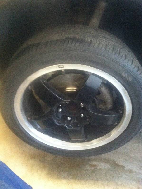

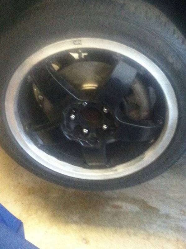

I couldn't agree more lol On a positive note I changed my brakes and rotors this weekend and found out the previous owner of my LS didn't know jack shit about installing Aftermarket Stereos ...hence he didn't even have the brand new pioneer speakers hooked up to the JVC deck that's in my car ...some ppl children lol
