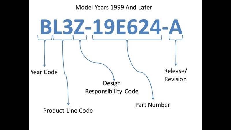

The first four digits completely change the part. But, might be entertaining to buy one and see how close it is!
No, seriously, won't work.
The first section identifies the chassis/platform the part is for. That's why some of the LS parts have a "4" if they're only for certain years or a "X" if for all years. Or something like that.
The second section is the part description. So 18125 just means "rear shock".
The third section is the revision or variation. Typical parts will just be an AA, then they change it if there's a design change. Parts that have variants - like shock valving, spring rates, alternator output, etc - have different third segments to identify which option package they go with.
That way the good parts counter guys can literally guess the correct part number if they know what you're looking for and the platform designation.
Additional data can be found here: Ford Part Numbering Chart
4W4Z means (4) 2004, (W4 means DEW98) or Lincoln LS, and (Z) Ford Customer Service Division Product Analysis.
