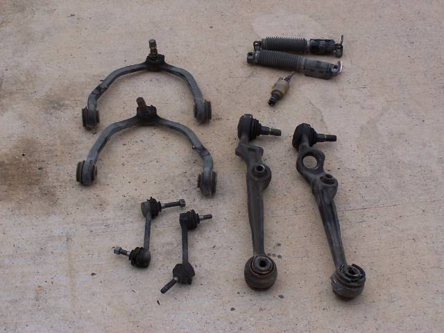

If any part of your suspension looks like the attached picture, it will cause squeaks. This is my suspension on my 97 before I replaced it.
I have replaced the UCA and the sway bar end links It sounded to me like a caliper rubbing on the left side which could explain the pull to the left do you think it could be the LCA's or anything else?
