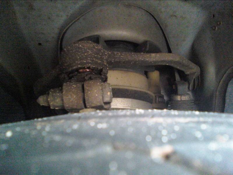

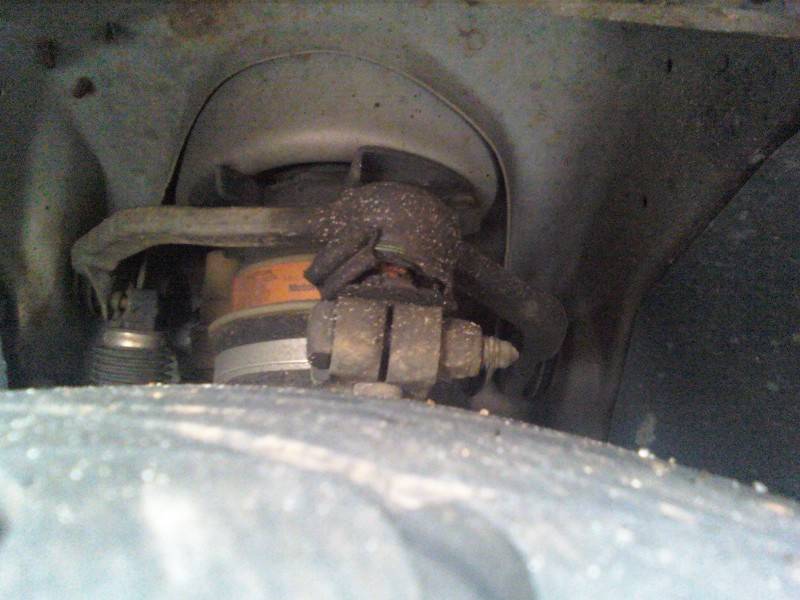

So my Mark has some suspension issues. The big issue right now is a horrible creaking and squeaking noise coming from both wheels. I'm going to assume that these completely shot bushings are to blame. What bushings are these and how much to replace them?
Also I occasionally get a clunking sound and when I quickly tap my brakes the car pulls hard right, but it won't pull at all if I smoothly get on them. What could be causing these issues? So far I've replaced an inner passenger side tie rod and the big bushing on the front of the lower on the driver's side.
So basically the whole suspension on both sides? Where can I find some decent bushings?
UCA and LCA - Moog or Ford
Strut Rod- Ford, only Ford!
If you go with Max at 5 star Ford you can get the OEM parts at very good prices.
excatly dont wait like i did when mine snaped and the lower ball joint popped out and the car slamed to the pavement and i about cryed i was so pissed fix it before u start huffing it everywhere ,,,
