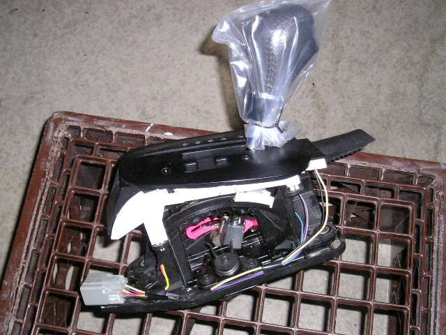

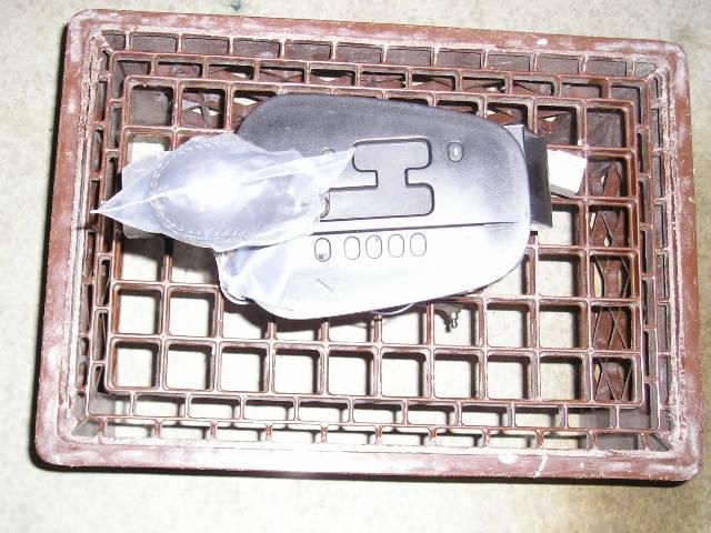

I have one. Want one? Comes with a deep charcoal leather shifter knob. $75 plus shipping to the lower 48.
Installation is pretty easy. You'd just need your dealer to reprogram the pcm to a sport calibration. Otherwise, when the shifter is in D4, the trans is actually in 3rd (which the display shows). Even without the reprogram, the SST funtion still works perfectly.
