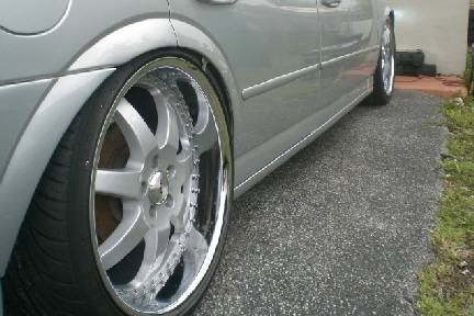

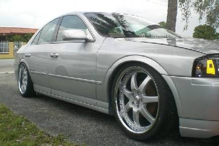

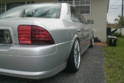

I didn't put them on. I would've if they went up for sale before my current wheels. The pics are of bigbody's car. Here's his info on the wheels:
The front offset is 25+ 8.5 wide the front tire is 245-35-20 i got 25 offset so the wheels would be flush with the car not so far in. The back is 40+ offset 10" wide the back tires are 275-30-20. I dont think you should have a big problem with a 38 offset but it all depends on how wide the wheel is but most 18" and 20" wheels are usually 8" wide. what kind of wheels is it that you want.

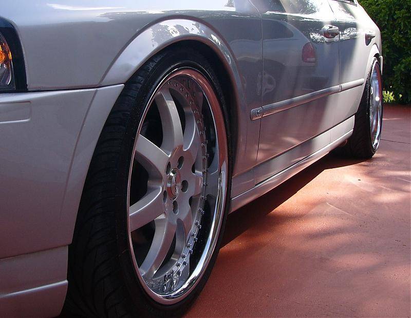

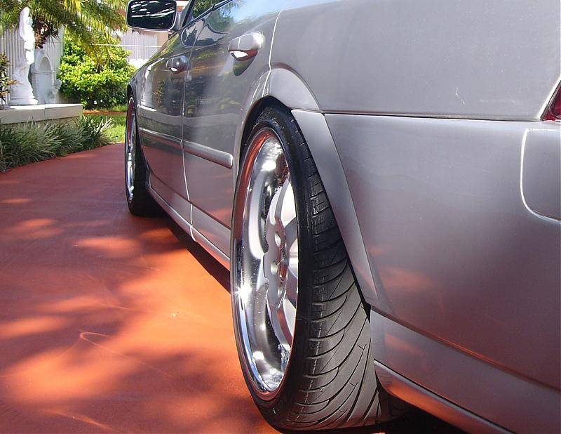

These are the Sevas S7's:
These are my wheels....they have sat in my garage for over a year now.
I sold my LS with the Foose Speedsters and have these beautiful Sevas chillin....waiting on an LS to pick them.....:(
