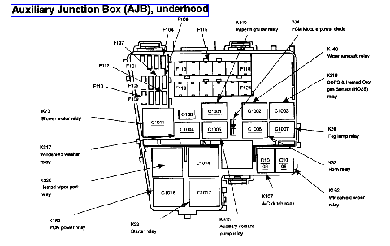

I have a 2000 LS V8 that is not starting. :mad: I don't have an owner's manual. I would like someone to let me know the location of the Starter Relay/s in the fuse box.

the pic is kind asmall, but is this what your looking for let me know and i can email it to u. the starter relay is C1017. i hope this help a little
