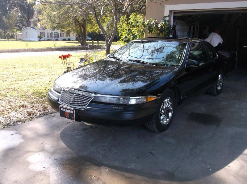

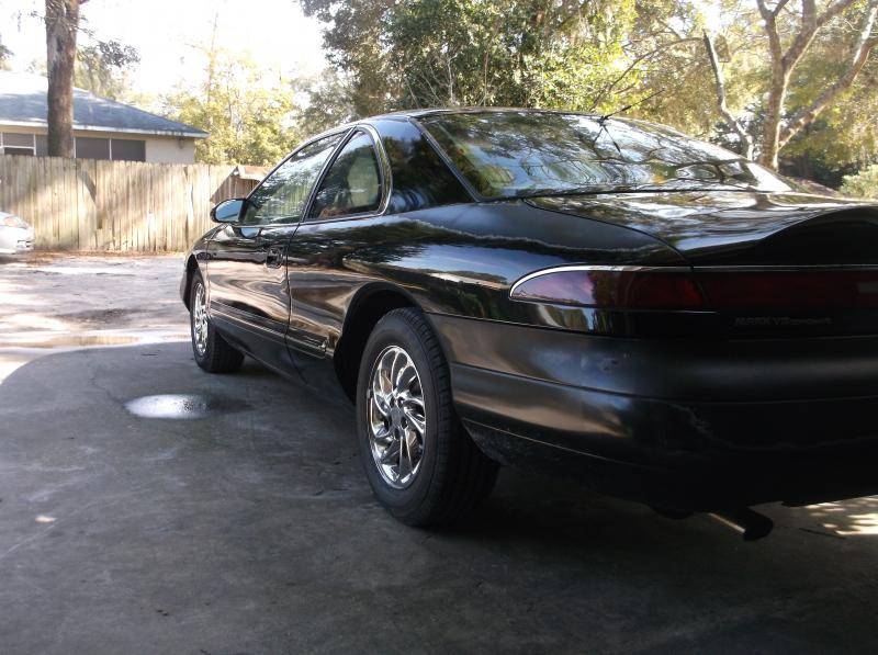

Got the new bushings in, new lower control arms, sighed all the adjustments, new rotors, new brakes, all the old brake fluid bleeded out, washed, drives nice and with all this done gives me a nice fuzy feeling looking at the old guy.. DSCF4251.jpgDSCF4252.jpg
I am of the school of thought that a good cleaning and an oil change always makes it run better.
