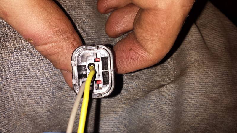

All the connectors seem straight forward to disconnect, except for the squarish/rectangle one for each of the lights.
It says "high voltage" and "headlamp wire cannot be disconnected." I have seem many posts here where the lenses are not on the car. Do you just cut the two wires? My stock HID's work fine and do not want to damage them.

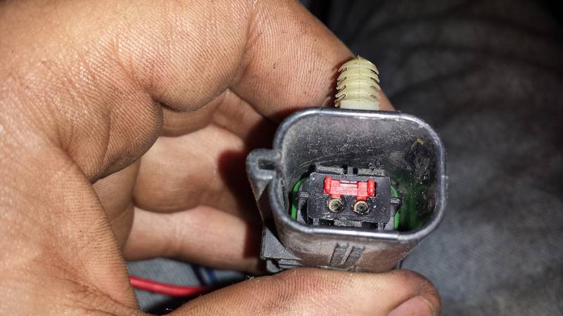

let me see what i can dig up.
pop the cap off the bulb side of the connector. you'll see 3 rectangles. there are 3 clips.
2015-12-30 22.27.58 by Chris Bratten, on Flickr
you can see in this picture where i broke the clips off so i wouldn't have to go through all that again. i just used a zip tie instead.
2015-12-30 22.28.42 by Chris Bratten, on Flickr
so you have to go in the connector from the headlight wiring side and pop loose all 3 clips. then it comes apart.
