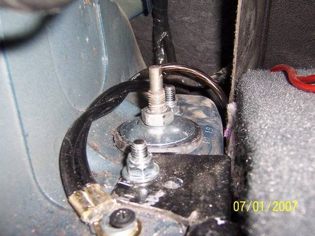

I have the rear shock tower brace for the MN12 in my Mark VIII. I had a local stereo shop add a carpeted shelf atop of it to mount the amps for the aftermarket stereo.
good investment? did you have to modify it to fit at all?

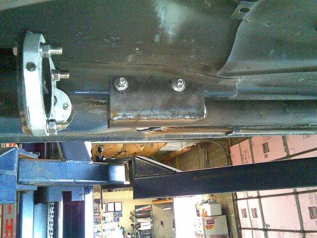

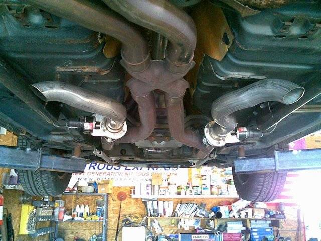

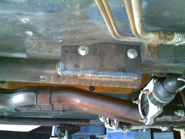

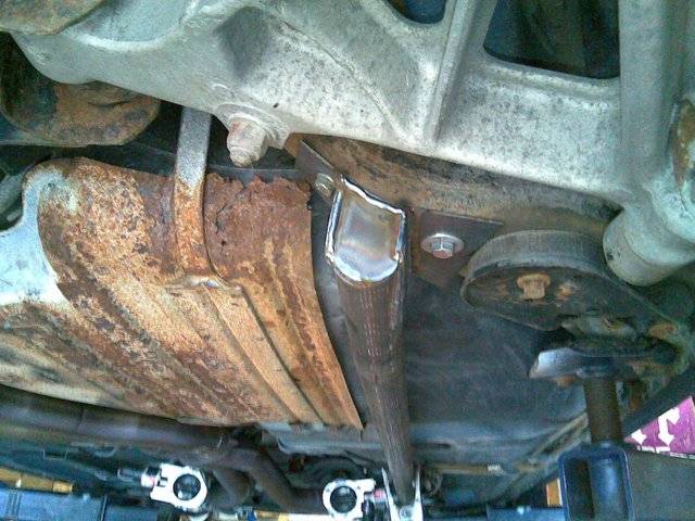

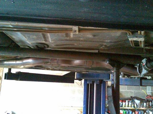

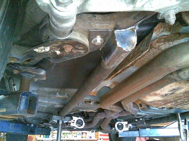

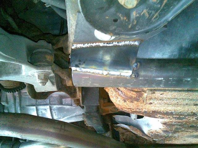

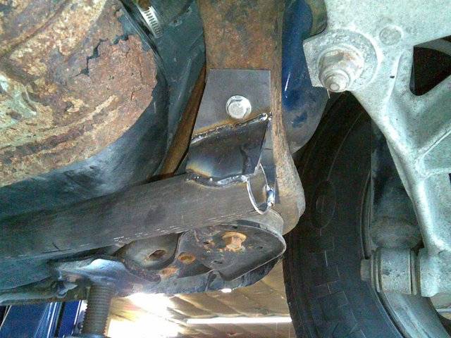

driller whats the reason for the cutoffs? and how did u go about building them subframe connects?

Unfortunately, this is one thing I do not have pics of. In this pic, you can see where it mounts at the shock tower.
The amps originally were mounted to the back cover against the rear seat area but they would not withstand the G-forces of launching at the track.
Slightly, had to drill new holes and do some cutting on the end brackets. I think they were meant to use the shock mounting bolts on the MN12? That wouldn't work on the FN10 for some reason.
The cutouts were for performance at the track. Off road use only. :D
I worked with the guy that did the exhaust on building the subframe connectors after doing a bunch of research. We figured out what we needed when working on the exhaust. We used the same high strength chrome-moly tubing he builds cages with. It was pretty basic, just a straight length of tubing with a slight bend at the rear so we didn't need spacer blocks at the rear subframe. The bracket plates were just custom cut from plate steel. The whole project took maybe 3-4 hours.
