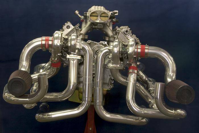

Sullivan Intake Manifold
you have to use their fuel rails, relocate the alternator and use their water crossover tube, some other intake tube, iac, buy their intake elbow, not to mention C heads..
other than that, its a bolt on :D
they are working on a B headed intake as well. something closer to a Cobra R style intake for our heads. or so thats the "rumor" from sullivan..
get that intake manifold with a Vortech 9psi s/c, and some 3'' exhaust and you, my friend, and in the 10's :D
yeah, i was reading about that about a month or so ago...its not for the everyday driver. It says that the sullivan takes over where the stock intakes give up, 7000+rpm. Unless you do a bit of rebuilding...theres no point to it. Oh yea, also youd need a taller hood.
That stuff is for forced induction applications. On an n/a motor, you'd actually lose low end power. Sullivan has some kick-ass stuff. They were going to make some stuff for B-Heads, but decided that there is no market for them...
