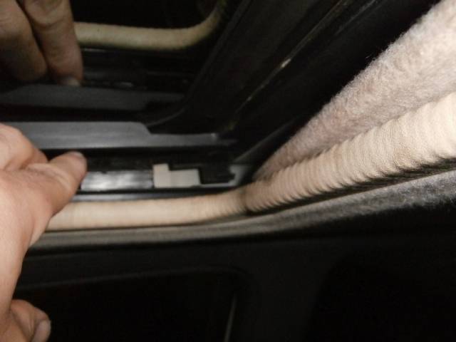

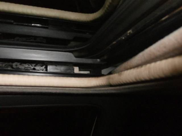

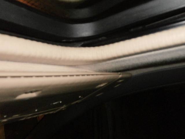

- it has this plastic frame around the perimeter that's firmly attached to the glass at the long front side edge, the other 3 edges hang down
-it doesn't make much noise while driving when the glass is all the way fwd/closed; when the glass is 50-100% recessed it makes a pretty annoying plastic type rattle while driving
should it be adhered to the glass all the way around? the sides don't fully conform to the shape of glass

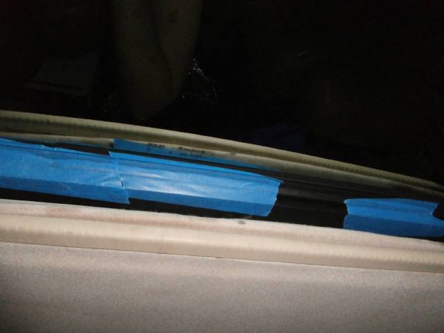

- I temp-ed the frame up in place against the glass with blue painter's tap and went for a quick test drive: most of the noise went away
-should I use some semi permanent adhesive or am I missing a mechanical fastener somewhere?
pass side back corner hangin down
and pressed up
pass side front corner
back long edge taped flush with glass

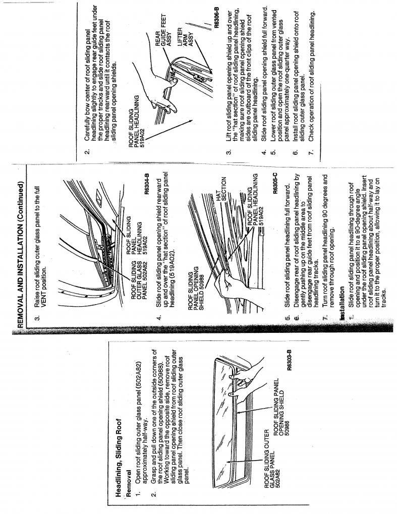

hdliner remove.jpgThis is from my 95 book about the slider. I remember it had two tabs glued at the front, about 1"x1" foam that looked like they dragged on the glass.
Gen 1 and gen 2 sunroofs are totally different. Glass is a different size, and gen 1's the track assembly is removed from the top, outside of the car. Gen 2's you have to remove the headliner, and take it down from inside the car. I've changed tracks in both generations and gen 1's are easier in my opinion. This is talking about factory installed sunroofs only. I haven't changed one of the aftermarket ones.
