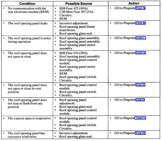

My sunroof went out about 4 days ago in my 00 ls V8. I checked the fuse in the trunk wasn't it. I'm thinking the motor went out on it. Do you guys know any other things it can be and if is the motor how much would it cost to replace.
It could be the switch. When you push/pull the switch does anything happen (noise, attempted movement, etc)?
here is a screenshot of the pinpoint idag by symptom.
here is the switch part no. XW4Z15B691BAA shows a list of less than 50 bux. I would start there unless you have fooled with any wiring lately. Also, if you were having problems with REM communication you would likely be having some other issues.
