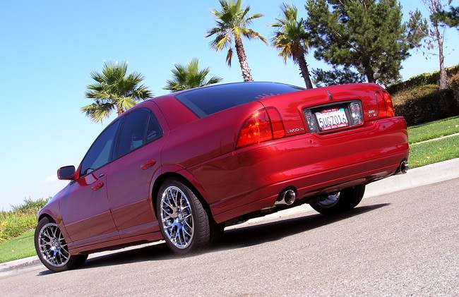

T_Man said:
Tony,
Your LS is looking sweet. I loved the chromed out CDC wheels. Too bad I sold the set of 18" CDC wheels I had. I was going to chrome those like you did.
Thanks Kenny.... remember that my first LS was a Midnight Gray 2001, so I've got a thing for your's too.
:D
The Vivid Red is very unique on a LS, Ive never seen one in person yet. T_mans car is awesome!! I also wish I had a midnight grey instead of my silver. The silver is kinda plain and common. Both of you guys have awesome rides!!!

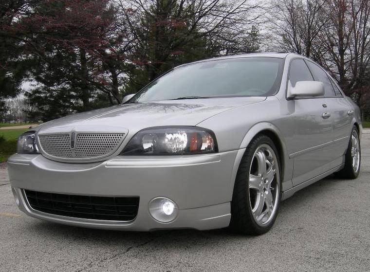

Hello, I am running 225/45/18 in front and 245/40/18 in rear. With the eibach springs. Using the stock shocks (not the sport). The ride is great and i only have to watch out for steep driveways and speed bumps in the street and parking lots. Also you will have to watch the curbs and parking lot stops. Sorry tried to load pictures but was told file was to big.
LEOV5 get some pics up of your car!! It looks sweet in the thumbnail/avatar, whatever its called.
